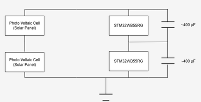

Hello, I am attempting in voltage stacking of 2 STM32WB55 board, but unlike arduino I could not connect Top board's GND to bottom board's 3.3 V pin. I would like to request for help or insights for alternative method I could make it work. I would really appreciate the help.
Problem
1. When I connect the Top STM32 GND to the VDD of Btm STM32, it discharged the voltage in Btm capacitor.
2. On one attempt I rearranged the circuit in similar stacked configuration, it did not discharged the Btm capacitor voltage. Instead the system goes haywire.
Thank you.

In this context it would meant the voltage in capacitor.
Once the voltage in capacitor reaches a certain threshold detected by the STM32 board, in this case is 3V, it consumes the voltage to carry out a task, I set it as sending bluetooth signal.
Because I am using 2 PV in a parallel arrangement, to ensure the testing environment is the same for both cases I am using 2 PVs. The arrangement I had could be incorrect, I am also unsure which is the configuration I need. I am still testing around and appreciate any info on I could make it work.
As for the arrangement above, I remember trying it but I forgot the result I obtained. But it is one of the problems I mentioned in the post:
But I will still try it out again within this week.

2025-02-26 8:43 AM - edited 2025-02-26 9:33 AM
@methene wrote:I remember trying it but I forgot the result I obtained. .
key to doing this kind of experiments is to keep detailed & accurate notes.
Do schematics of the actual configurations you've tried, and record the results. Take photographs.
You didn't try it with the USB connected to the boards, did you?

@methene wrote:As for the arrangement above, I remember trying it but I forgot the result I obtained. But it is one of the problems I mentioned in the post:
Don't try to remember results. You write down the results or save the results from your oscilloscope or logic analyzer. Or you take a photo with your phone.
@methene wrote:1. When I connect the Top STM32 GND to the VDD of Btm STM32, it discharged the voltage in Btm capacitor.
What does "it discharged the voltage in" mean? It's not correct use of terminology and probably not grammatically correct either. I have no idea what it means.
@methene wrote:2. On one attempt I rearranged the circuit in similar stacked configuration, it did not discharged the Btm capacitor voltage. Instead the system goes haywire.
Define haywire. What happened? Or what didn't happen? I assume one MCU received all the voltage and was being fried while the other one shut down due to too low voltage.

I tried to keep it as detailed as possible, will be more careful
@Andrew Neil wrote:You didn't try it with the USB connected to the boards, did you?
No, I did not, since I am using PV generated voltage
