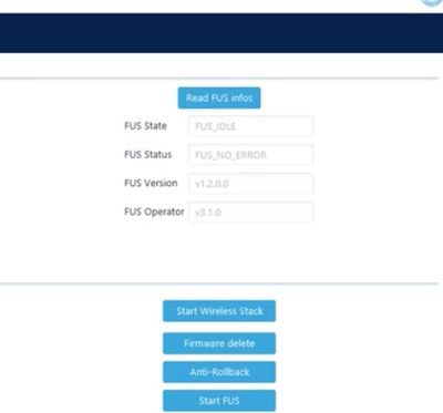

have you clicked on the button. ’Start wireless stack’ before uploading your up. If the stack and FUS are very well working, I think you should create new thread (after selecting a best answer for the stack donwlaod issue) where you give a full description on the zephyr application you are using and how it behaves.

2025-06-15 11:30 PM
Hello @Lee_T and welcome to the ST Community.
Could you please provide the bin file for the FUS that you have used together with the STM32CubeWB version. If you have downloaded the New FUS version v2.0.0, you have to be aware that:
If you are using the FUS V1.2 and the stm32wb5x_BLE_Stack_full_fw.bin from the STM32CubeWB V1.22.1, be aware that the stm32wb5x_BLE_Stack_full_fw.bin from the STM32CubeWB V1.22.1 is compatible only with the new FUS version 2.0.0.
If all that is working fine, try to click on the "Start Wireless Stack" button on the STM32CubeProgrammer after successfully uploading the FUS and Stack.
Best Regards.

2025-06-16 1:48 AM
This limitation concerns the STM32CubeProgrammer V2.19.0 (the first version that does support the FUS V2.0.0).
Best Regards.

2025-06-17 1:41 PM
Hello @Lee_T
please read the first warning on my first answer ‘ With FUS v2.0.0, Coprocessor Binaries can be installed only through the USB interface,
Currently CubeProgrammer versions do not support “FW_delete” command when using the ST-Link interface.´. So, you can’t install the stack throw the ST-LINK. You have to use the USB. This is a known limitation for the STM32CubeProgrammer V2.19.0.

Hi STTwo-32,
The Nucleo WB55RG board I am using has an onboard STLink, which is connected via a USB connector. Is this the USB connection you are referring to? If not, what USB connection is used and what selection is made on CubeProgrammer?
In addition, I still have not found the "Start Wireless Stack" button in Programmer.
Apologies for all the questions.
Regards,
Lee
2025-06-17 3:16 PM - edited 2025-06-19 6:44 AM
Hello @Lee_T
To understand how to connect in USB DFU mode, please have a look at this video specially the part after 4:50. For the ‘Start Wireless Stack´, you can find it as you can see on this screenshot:
Best Regards,
STTwo-32
2025-06-19 6:33 AM
Hi STTwo-32,
I've tried three different browsers and none of them show a video in your reply. Did it not get posted?
Regards,
Lee
2025-06-19 6:46 AM
I've updated my answer with the video link attached to "this video" word.
Best Regards.
STTwo-32
