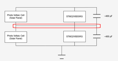

Hello, I am attempting in voltage stacking of 2 STM32WB55 board, but unlike arduino I could not connect Top board's GND to bottom board's 3.3 V pin. I would like to request for help or insights for alternative method I could make it work. I would really appreciate the help.
Problem
1. When I connect the Top STM32 GND to the VDD of Btm STM32, it discharged the voltage in Btm capacitor.
2. On one attempt I rearranged the circuit in similar stacked configuration, it did not discharged the Btm capacitor voltage. Instead the system goes haywire.
Thank you.

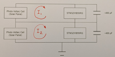

And the connection you showed is not series:
What is the purpose of that central connection?
That's what makes it not series! It gives you two separate current loops"

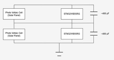

PS:
Did you mean this:

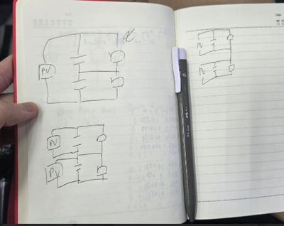

Yes, they did on chip implementation, I do believe there are much easier and methods that made more sense. I am trying out different possibilities as well because I am not sure what is correct, but my goal it to implement and observe the halving of current.
These are some of the other connection method I had done previously, which I am still stuck at connecting them in a configuration of top to bottom board.

Another thing that doesn't make sense: you have two PVs, and two microcontrollers. There's no benefit to connecting them in series, because each one will still be seeing the same current!
There is no halving of the current in this case!

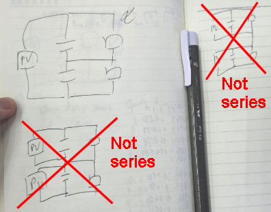

2025-02-26 6:57 AM
@methene wrote:These are some of the other connection method I had done
Only one of those is actually a series connection:

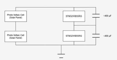

2025-02-26 7:00 AM
@methene wrote:So, you are suggesting it is simply impossible to have top board's return connected to bottom board supply.
Not impossible - but of no benefit.
This connection should work:
But it's not a series connection. In this arrangement, each PV is powering one MCU board separately.
