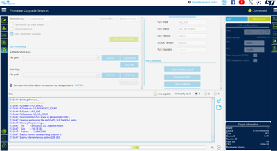

So I decided to delete the stack and install 1.19.1 old stack with FUS 2.0, but i cant, it shows "Warning: FUS-STATE_IMAGE_NOT_FOUND". I also get the same image when i try to change The FUS version itselt to 1.2.
Now neither I can Upload any version of FUS nor any BLE stack. I also used USB DFU Mode none can erase and download FUS or BLE stack at sector 0. The application just hangs up.

I also tried mass erase and try to download the FUS and stack again and it wont work.

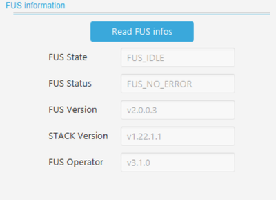

I have checked after mass erase there is no value at FUS start address by reading the flash, yet shows FUS version.

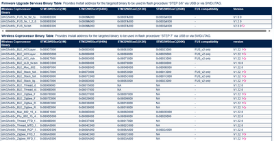

Could you please try the USB mode using the STM32CubeProgrammer V2.19.0 and the .bin file available on the STM32CubeWB V1.22.1 for the stack file. Also, make sure to set the start address manually on the STM32CubeProgrammer according to the addresses available on this table:
