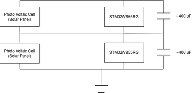

Sorry for being unclear, I had attached a image that I had drawn for better explanation of my issue.
2025-02-25 4:10 AM
Thanks for adding the diagram - these things are so often better described by a diagram than in words.
But some more detail is required:
Also, what is the purpose of connecting the boards like that anyhow?
Why not just have them separate, or in parallel?

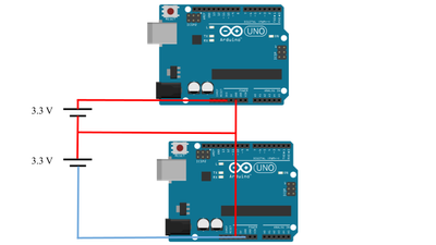

This is my research topic for my bachelor degree. I am attempting on a power management method called voltage stacking, it is commonly used on transistor level design. The advantage of doing voltage stacking or in series arrangement is the reduction of current demand of each domain that are stacked, following V = IR.
My goal is to find out that in an energy harvesting system, could I achieve what is observed on transistor level if I attempt voltage stacking, which is halving of current demand or 1/n where n is the number of stacked layers. I had tried out the parallel arrangement and observed the data but I faced problem when trying to connect them in series.
1. When I connect the Top STM32 GND to the VDD of Btm STM32, it discharged the voltage in Btm capacitor.
2. On one attempt I rearranged the circuit in similar stacked configuration, it did not discharged the Btm capacitor voltage. Instead the system goes haywire.
I attempt voltage stacking with arduino initially I had attached the image below, I know it looks disturbing or obnoxious but with this I could observe a near halving of current demand compare to conventional parallel arrangement. Currently, is that I would like to replicate similar result with STM32 boards.

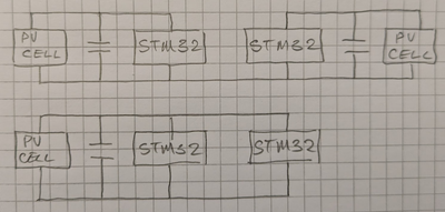

But microcontroller boards aren't just simple resistive devices that you can connect in series, and apply Ohm's law.
They contain voltage regulators, and other non-linear stuff.
Current consumption is discontinuous, and the two boards will not be drawing the same current at the same time.

I don't see how your arrangement achieves that:
This is not a series connection!

@methene wrote:The current of the 2 boards are not exactly the same but it should have been halved compared to conventional ones.
But, if they are in series, they must - by definition - be the same. They cannot be different.
You would have to make some sort of shunt regulator, which would largely - if not entirely - defeat the object!

The boards are simply not designed to work in this way.
If you really want to pursue this, you're going to have to do a custom board design which is specifically designed for this. Even that is likely a dead-end, as the chips themselves have not been designed for this.
If you're interested in maximising energy harvesting, I would suggest that you look into switched-mode power supplies, and Maximum Power Point Tracking (MPPT)...
