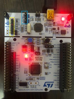

Removed the ST-Link plastic jumpers and all four pins are free now - as shown on the blue rectangle. As well as, the yellow rectangle shows the 6 pins of CN4 on one column.

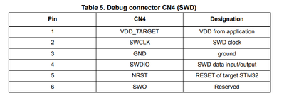

It seems that pins 1 and 3 are 3.3 V and GND respectively based on the use manual (https://www.st.com/resource/en/user_manual/um1724-stm32-nucleo64-boards-mb1136-stmicroelectronics.pdf)
but when I check those two pins using a multimeter I get no voltage! Any idea where is the issue?

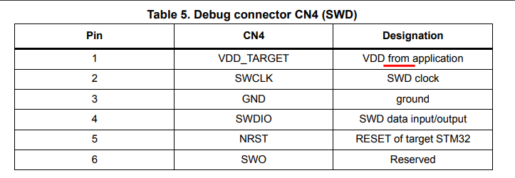

2025-09-12 2:24 AM - edited 2025-09-12 2:29 AM
As @mfgkw said, and as shown in the table you quoted, pin 1 is VDD from the target - it does not supply power to the target:

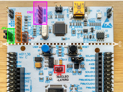

To be really sure that the ST-Link is fully disconnected from the STM32F411RE on the Nucleo board, you can break-off the ST-Link part:
Picture credit: @MM..1 via https://community.st.com/t5/stm32-mcus-products/3-3v-power-supply-for-nucleof103/m-p/657826/highlight/true#M240024

2025-09-12 3:06 AM
There is no need to break the board off.
- Remove the two jumpers
- connect at least VDD_TARGET, GND, SWCLK, SWDIO and NRST between your blue pill board with CN4 of the ST-Link
- if you need Traces via ST-Link then connect SWO as well
- power your blue pill board from any source
- power and connect the ST-Link via USB cable to the PC

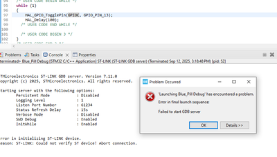

2025-09-12 5:05 AM

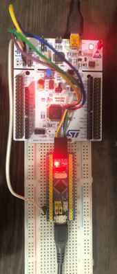

Created a simple project (just to toggle the onboard LED of the blue pill) and tried to run and debug it using the ST-Link.
Removed the two jumpers of ST-Link (CN2) and here's the wiring:
Blue wire: from 3V3 (blue pill) => pin 1 of CN4
Green wire: SWDIO (blue pill) => pin 4 of CN4
Brown wire: SWCLK (blue pill) => pin 2 of CN4
Yellow wire: GND (blue pill) => pin 3 of CN4
Wight wire: R (blue pill) => pin 5 of CN4
Both boards are connected to the PC using separate USB cables.
Now I get the error below when trying to run or debug!
What is the problem now!? :|
2025-09-12 5:30 AM
It looks ok for me.
But keep in mind that blue pills are regularely faked STM for quite a long time now. I have one here, which does not work with STMCubeIDE. It can be flashed with via hex file with STM32CubeProgrammer, but even that is not reliable. (It came in a set along with ST-Link clone, which does not work either...)
Black pills where usually better when they appeared. But I assume the situation with black pill is not really better meanwhile.
As long as you have no original STM product you will find not much help here. And to be honest it is wasted time to save a few bucks. Maybe you have more fun with real hardware. Switch to a NUCELO board or a naked CPU from a trustworthy source.
