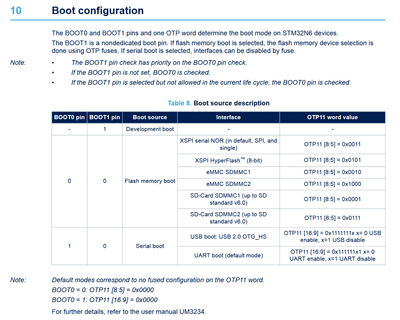

It would be good to add a mention of this to AN5967 since I followed that to design the hardware, and no other STM32 locks you out of the debug port just by putting it into flash boot.

I'm surprised that the application note you mentioned doesn't recommend connecting the Boot pins to ground via a resistor - that would be one of my golden rules designing any STM32 board, that way you will always have an escape path if things go wrong. Hopefully they will add something similar to the application note - in bold.

Hey thanks for the response, I could remove it and put it on another board, but then I'd need to make another board which would be more time consuming than just tweaking the one I have and getting another one manufactured. Someone else had this same issue and they solved it by drilling through the other side of the board, which I don't have the equipment for sadly.
For reference here is what the app note says about boot modes, the following section on debugging also doesn't mention it :\
Please update your documentation ST!
