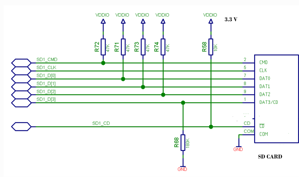

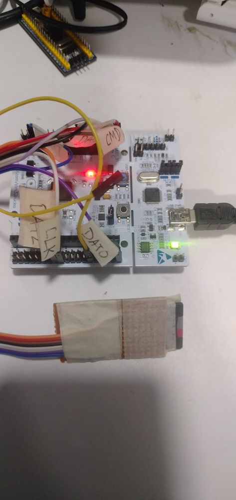

I have Nucleo f446RE board and I need to interface an SD card with the same board using SDIO protocol.
I am using SD card adaptor for connecting the SD card with Nucleo Board. Please see the image.
The connection is exactly the same as in the image.
I hope it is clear.

Abin,
Thanks for your sharing. The schematic is no issue, even we can config internal pull-up/pull-down without external resistor to respect the SDIO specification.
I don't find the right MCU pinout for SDIO and the connection. But I think it's not the big issue if you checked them carefully.
I'm worried about the signal integrity because you used the flying wires for SDIO communication. For my understanding, it maybe the issue happens on the L446, but not on the L476. It should be better to use oscillator to confirm the signals.
If not, I suggest adding more GND wires close to SDIO signals to check if the SDIO communication can create.
