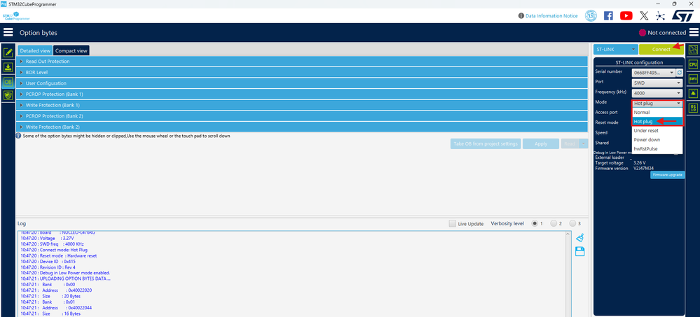

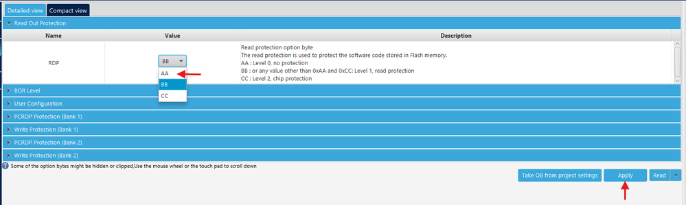

Hello @Shaf ,
To perform RDP regression from Level 1 to Level 0, you need to use STM32CubeProgrammer.
At RDP Level 1, the flash is locked, so you cannot upload new code as you suggested.
To perform the RDP regression using STM32CubeProgrammer:
  • Connect to the board in Hot Plug mode.
  • Change the RDP to AA and apply the change.
  • A full mass erase should have been performed.
Best regards
