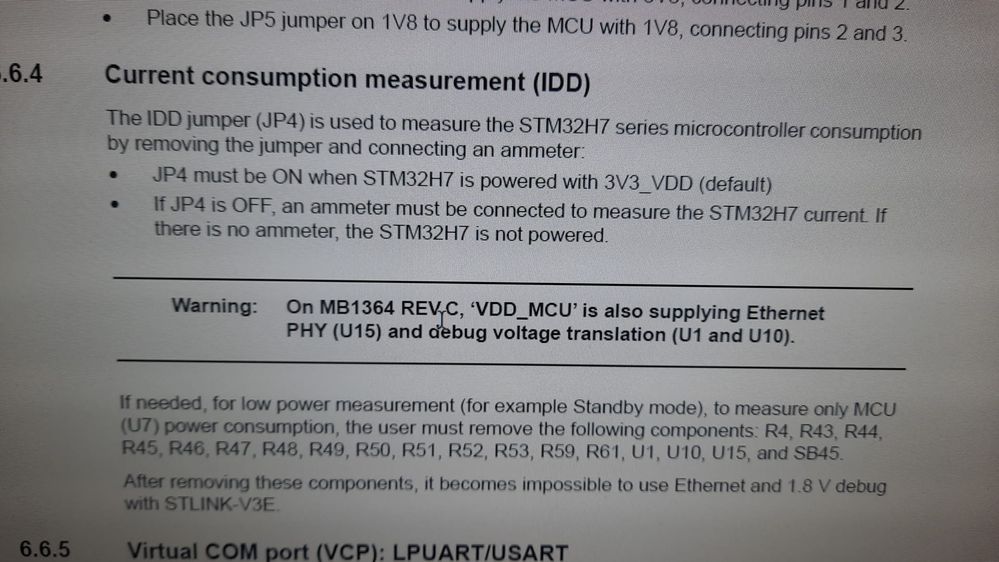

2025-01-31 7:54 AM
As @AScha.3 said, check that what you're measuring isn't including other things on the board - especially the ST-Link:
2025-01-31 7:56 AM
@NMast.1 wrote:The jumper is actually made to measure the current of the MCU.
But that will include any current sourced from the MCU; whether intentionally, or by "leakage" to other stuff on the board - such as the ST-Link.
See the link I posted earlier.
