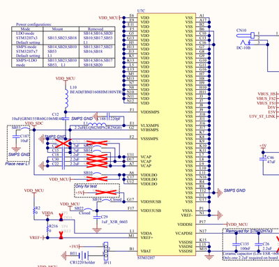

2024-04-30 9:13 AM
Did you set the correct power mode , according to the settings on your board ?
(smps mode, i suppose)
see circuit:
2024-05-06 8:36 AM
Could be that I recovered somehow.
Key steps:
1.Yes, I need to use the external power supply (5 VDC)
2. In project properties, run/debug settings .... GDB connection settings, frequency of ST-LINK debug probe to be set to, say, 1000 kHz instead of "auto".
3. I found a project from examples folder to be uploaded right after flash erasure. Perhaps I might have done an empty project myself. Perhaps. But a project that is generated by IDE as a default one is definitely not good to be used for board (re)initialization. So, there need a project to be used for first uploading.
4. In SW1 = 0 mode both cores (M4 and M7) have to be uploaded at least once, so that flash comprises both images. Only after that the main func of M7 starts properly, as it waits for some actions of M4 at the beginning.
Not sure, I can say: "all right", but at least I moved on.
2024-05-17 5:42 AM
A small question.
I see in my project (in ioc-file): RCC.SupplySource=PWR_LDO_SUPPLY, whereas it should be PWR_DIRECT_SMPS_SUPPLY. If I create a new project for the same board, the value PWR_DIRECT_SMPS_SUPPLY is by default. But in the working project I have no chance to select it, as it's absent in the menu. How to fix?
2024-05-17 6:55 AM
The DIRECT_SMPS should be there, maybe try : set chip revision V , set voltage scale 1 . (Just try...never seen this problem.)
Is this "working project" so big ? If not, start new project (from correct board definition) and then just copy your user code parts from "working project" to the new main.c .
