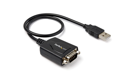

Then I connected it to a PC com port (USART1 via CN2). To do that I used a USB to COM convertor from StarTech.

If your USB to COM convertor from StarTech is RS-232, you cannot connect that directly to USART pins...

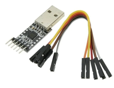

So replace the damaged cpu's , or buy new board. Then use for USB - Serial converter something like this :
USB -> serial (3.3 V level)
https://de.aliexpress.com/item/32696427768.html

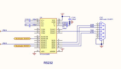

but CN2 is :
But then : what he did wrong ?
2024-04-23 12:04 PM
CN2 is a DB9 RS232 port on EVAL board, top center-left
https://www.st.com/en/evaluation-tools/stm32h757i-eval.html
I don't see this electrically damaging the board unless something is very wrong with the PSU and grounding situation.
