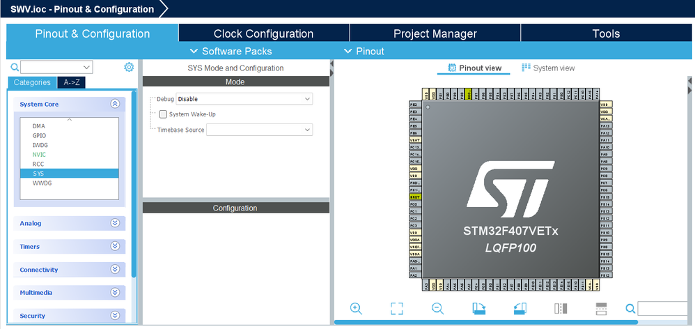

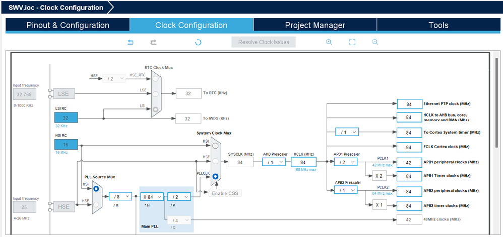

  • In the .ioc device configuration, I changed the clock to 84 MHz.

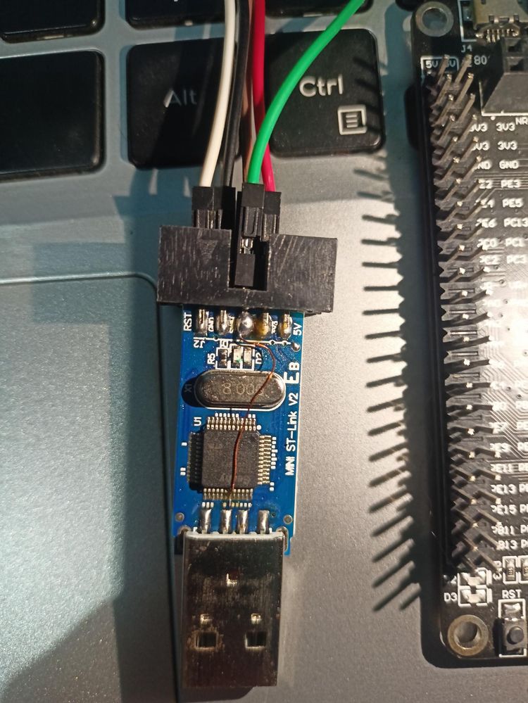

Hi @Tesla DeLorean thank you for the quick response,
I just debugged the problem with the PB3/SWO pin. It turns out that this ST-Link USB stick doesn't have an SWO pin to connect. I followed a YouTube tutorial on how to extract the SWO connection from the ST-Link and now the STM32f407VET6 able to use print the printf statements.
Here is a picture of my ST-Link with the SWO connection I made.
Hope this helps others facing the same issue.

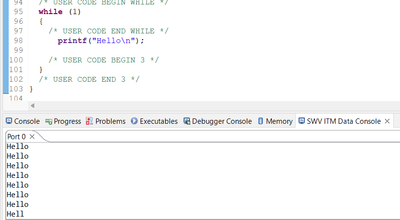

Result :-

Result :-
