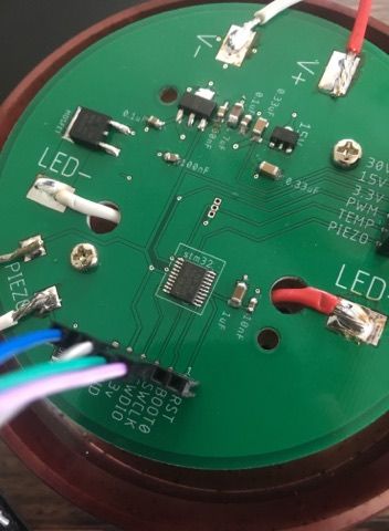

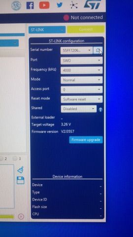

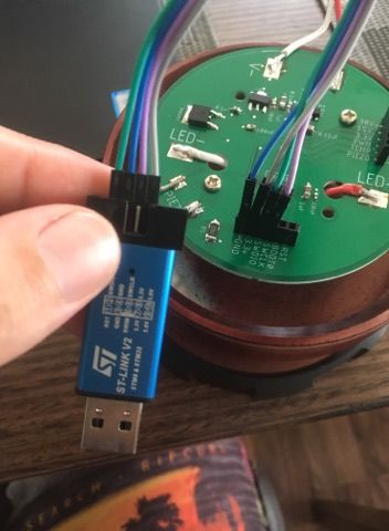

The St_link registers itself and the serial is updated etc. however when I attempt to connect to the newly soldered chip, I get the message that "No STM32 target found".
Am I attempting to program this chip incorrectly by using the SWDIO, GND, SWCLK and 3.3v single wire connections.
There is little to no examples I have found to do this, as most examples are for the premade nucleo boards etc.
Any advice would be greatly appriceated, or a reference to the correct data.

At least GND and 3.3V appears to be working, because ST-Link is able to detect it.
Have you tried other settings, like connect under reset, or lower frequency?
