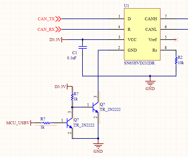

I am using STM32F103 for my project and it requires CAN most of the time however if a USB connector is plugged in, it should behave like a virtual COM port.
CAN_R and CAN_T pins are connected to PA11 and PA12
together with USB_DP and USB_DM pints.
Below image is the circuit I used to disable CAN transceiver when USB 5V exist.
MCU_USBV comes from the USB 5V and USB_DP is pulled up.
This circuit didn't work for me.
What need to be changed?

Hi @Amel NASRI ,
as CAN and USB share pins, it does not appear that the problem is in trying to use both modules simultaneously.
I believe the main problem is in how the CAN transceiver is "disabled" - floating its GND pin is not a proper way, as the chip gets parasitically supplied from its other pins through the protection diodes.
A multiplexer or a three-stating gate (e.g. 74HC125) or a transmission-gate (e.g. 74HC4016) should be used to isolate the CAN transceiver's D and R from the USB DP/DM terminals.
