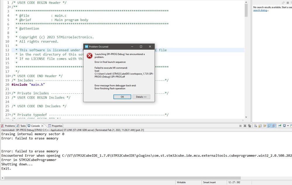

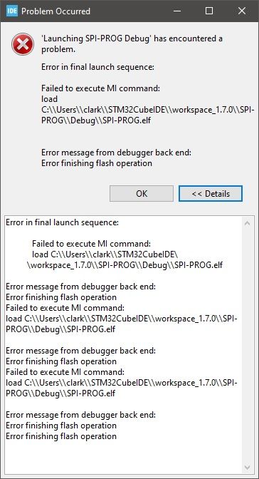

Attached is a screenshot of the error. Has anyone else had this problem? Has anyone else been able to find a solution?

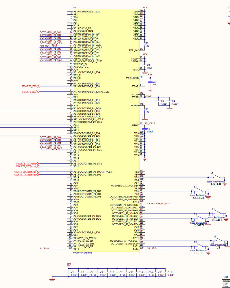

I would like to say that I have found the issue. The MCU seems to program every time now but I cannot completely validate it due to temperature constraints. In my schematics, I have a 10nF capacitor on the VREF+ line to ground. I misread the schematics and instead placed a 10uF capacitor. After replacing that capacitor with the correct one, the board seems to operate properly.
What I find interesting is that the VREF+ line is connected in parallel to the VDD line. I have thirteen capacitors on the VDD line that are all 0.1uF. So I don't know exactly if that one capacitor truly is the problem. All I know is that the MCU hasn't had an issue since I replaced that capacitor.

But I may have an answer for this. My design is utilizing a fixed 3.3V LDO. Output voltage is roughly 3.325 to 3.35 volts. I have removed the regulator and supplied voltage from a bench top power supply. For some reason I set the voltage at 3.20 volts instead of 3.30 volts. But it programmed. It programmed every time. So I began stepping up the voltage in 10mV increments. It started getting problems between 3.22 and 3.25 volts. It was inconsistent in that range. But if I drop it to 3.20 volts, it consistently works. The programmer only works when it reads 3.22 volts or less. It never works when it read 3.23 volts or higher.
This is worrisome. On our production design, I am operating at 3.34 volts. I have never had this issue with that design or any other design for that matter. I'm guessing that I have a pin somewhere along the way that should be within a range but it's slightly too high.
I've included the schematics of the MCU. Maybe someone can point me in the right direction of incorrect pin connections.
