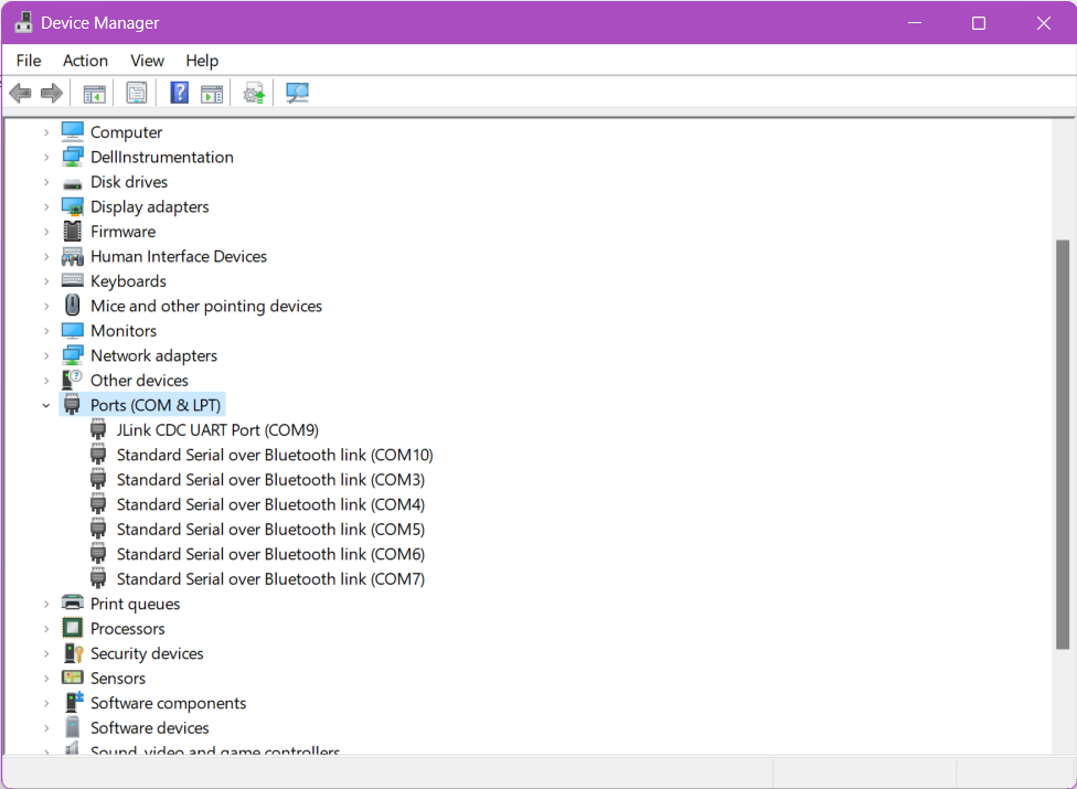

I'm using Nucleo - L496ZG board in our project.
Whenever I connect the USB cable to the CN1 connector, the ST-Link isn't detected.
I have checked the ports on Device Manager and it shows Jlink instead of ST-Link.
I am attaching the image for your reference. Awaiting for your response!

2024-04-03 9:18 AM - edited 2024-04-03 9:31 AM
@SK.22 wrote:I have checked the ports on Device Manager and it shows Jlink instead of ST-Link.
Segger have a utility to convert an on-board ST-Link to an on-board J-Link - looks like this has been done to your board?
Obviously, after converting the ST-Link to a J-Link, it will no longer be detected as an ST-Link!
If you want to go back to using it as an ST-Link, the Segger utility can also be used to convert back
Addendum:
https://www.segger.com/products/debug-probes/j-link/models/other-j-links/st-link-on-board/
Or, as @Pavel A. said, just carry on and use it as a J-Link (subject to the Segger Ts & Cs - see the above link)

2024-04-03 9:14 AM - edited 2024-04-03 9:15 AM
Can it be because someone has updated the ST-LINK firmware to J-LINK?
If so just tell the debugger that you have J-LINK and enjoy.

2024-04-04 12:39 AM
Hi Andrew and Pavel,
Thanks for the solution.
Cheers! It works now, and it is now changed to ST-Link.
Thanks!

2024-04-04 1:25 AM
I misunderstood your issue. I thought you have two devices connected to your PC: JLINK and STLINK and only JLINK is shown in the device list. Sorry for that.

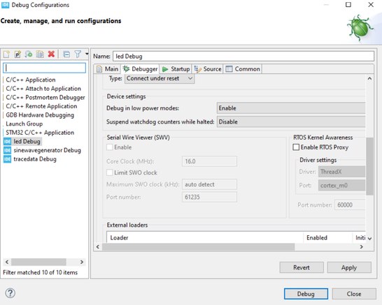

Hi there,
I'm facing another issue,
After switching from ST-Link to J-Link, the SWV is disabled, as shown in the image below.
How to see the live data? Kindly share your ideas on this.
Thanks!
2024-04-04 2:54 AM
For a new issue, please start a new thread - so that the title matches the actual topic of the discussion.
