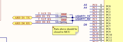

@mƎALLEm wrote:on NUCLEO-G474RE, VCP is connected to USART1 and you should solder SB12 and SB20 as I stated previously.
The User Manual says LPUART1 by default, or USART1 by changing SBs ?
Screenshot above.
2026-01-27 4:02 AM - edited 2026-01-27 5:12 AM
@Andrew Neil wrote:
Screenshot above.
In fact, it could be both (USART1):
or (LPUART1 the default configuration)
He needs to play with the solder bridges.

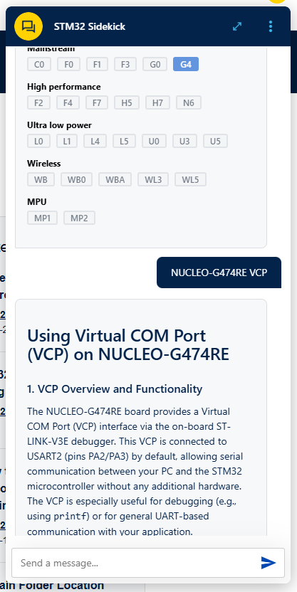

2026-01-27 4:10 AM - edited 2026-01-27 9:01 AM
@Andrew Neil wrote:
@mpek29 wrote:I've gathered that it’s possible to achieve the same functionality using UART2 instead for the NUCLEO-G474RE. .
Where did you "gather" that?
@mpek29 Did you ask ST's AI assistant, "Sidekick" ?
It does say UART2:
But that is wrong!
PS:
This is due to out-of-date information in AN4989: - see here.

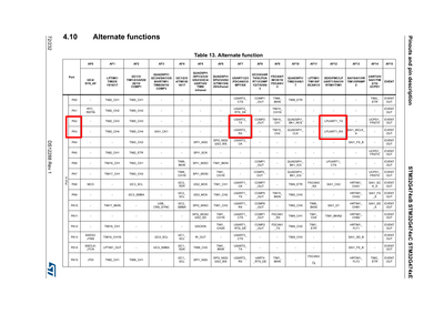

2026-01-27 5:52 AM
USART2 can be used at PA2&PA3 in the same way as LPUART1 can be.
Something has probably got lost in the clicking.
