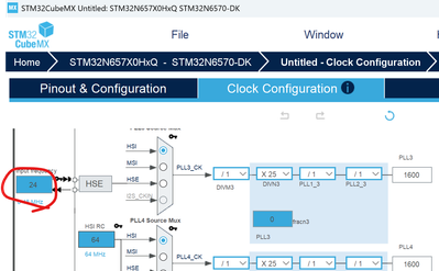

I confirm that default template for both N6 DK and N6 Nucleo are wrongly generated using a base frequency for HSE=24MHz. I forward this update request to CubeMx internal team for correction.
Thanks for your input relative to this typo.
Regards,
Simon

Can you please share which projects please ? I performed a quick check on template project for example and HSE frequency was 48MHz.

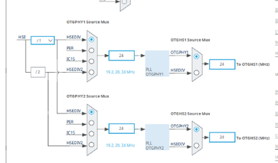

Please note from product reference manual HSE peripheral has an optional DIV2 output.

What do the board User Manual and Schematics say ?
2026-01-26 9:09 AM
The schematics tells 48 MHz: https://www.st.com/resource/en/schematic_pack/mb1939-n6570-c02-schematic.pdf
(In doubt I would use what is printed on the crystal on my board...)
2026-01-26 9:16 AM
A default project created on the board for me shows 24 MHz, not 48 MHz. Maybe templates are correct, maybe not. The result is still wrong.
2026-01-26 9:28 AM - edited 2026-01-26 9:31 AM
@Simon V. The projects are from Infineon AIROC https://github.com/Infineon/AIROC-Wi-Fi-Bluetooth-STM32 but also when I generate a project from board selector. CubeMX 6.16.1 and MPU package for STM32N6 Series version 1.3.0.
I checked the crystal under a microscope. It is labeled 48MHz.
@TDK That is what I see too.
Regards,
Simon
