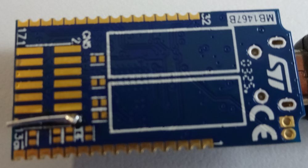

I have try out with Realterm and Hterm. I dont belive that we have CR/LF problem. I have a scope - I could check if a signal was transmitted.
Suti71
Associate II
I have connect my osci probe on jumper( soldered bridge ) and Pin 5+7(GND), but nothing happends. Do it works with a target board only? I want to integrate the board into my hardware and therefore wanted to check beforehand whether the UART VCP communication is working. As I see it, I will probably have to connect a target board. I really dislike such incomplete documentation.

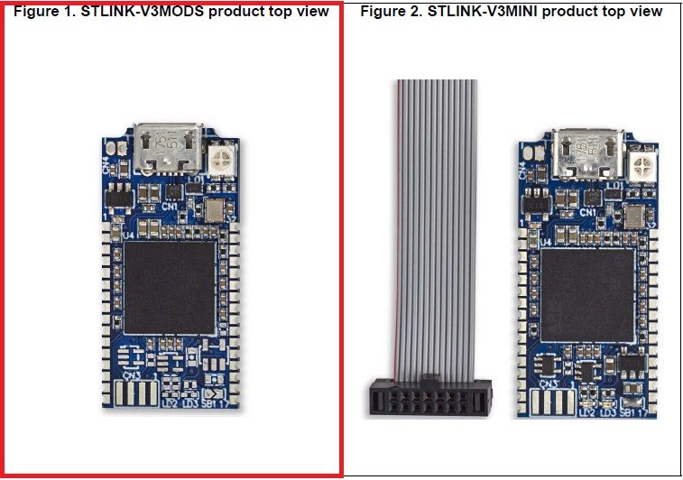

Or could it be, that on my board( red ) are electronic components missing (see below)?
