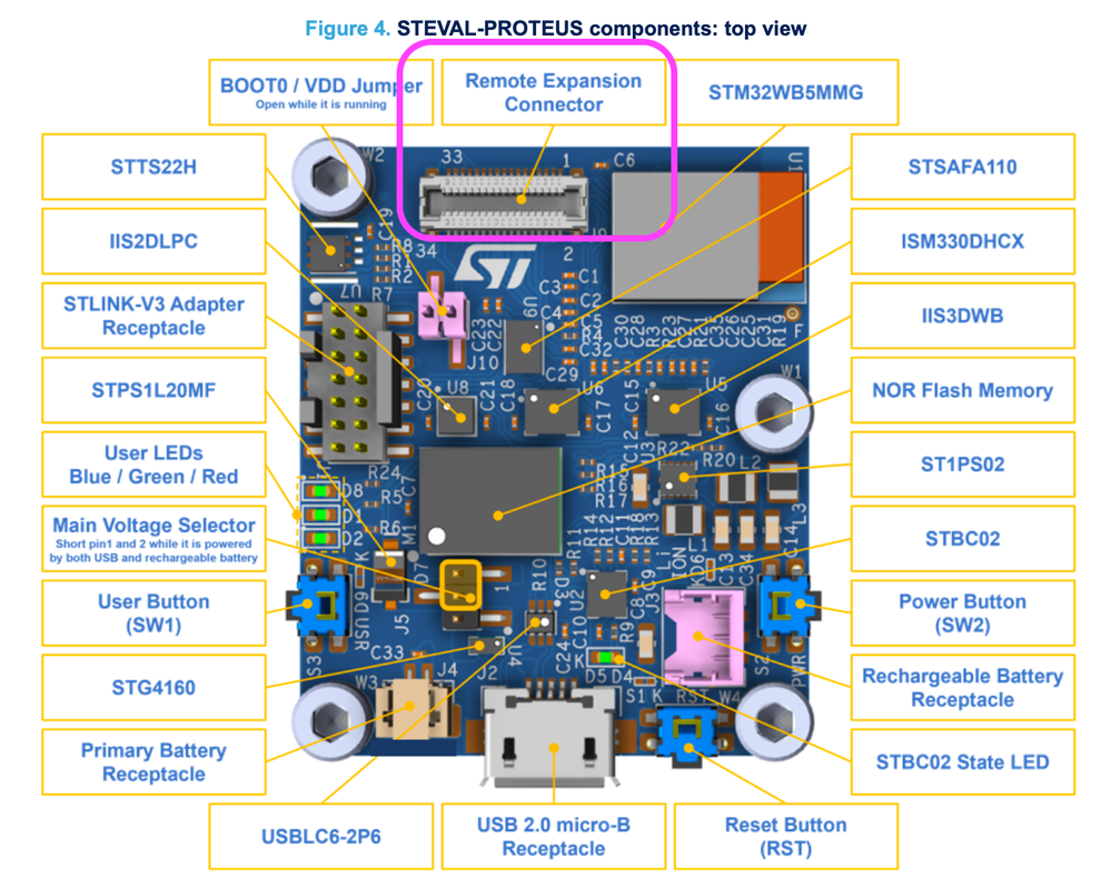

Hello everyone,

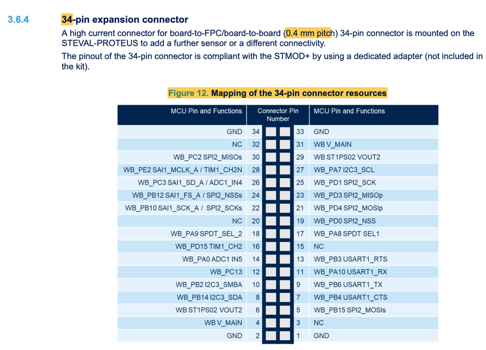

I’m currently working with the STEVAL-PROTEUS1 evaluation kit. According to the User Manual, the board features a 34-pin, 0.4 mm pitch high-current connector for board-to-FPC or board-to-board expansion. It is stated that:
“The pinout of the 34-pin connector is compliant with the STMOD+ by using a dedicated adapter (not included in the kit).”
I would like to know how I can obtain this specific STMOD+ adapter or a compatible 34-pin cable. Is there an official STMicroelectronics part number or recommended distributor for this accessory?
Any guidance would be appreciated.
Thanks in advance!
