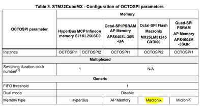

Thank you for sharing your project. For the first check, I noted the memory type is wrong. For DTR read the memory must be configured as "MACRONIX"  as mentioned in AN5050.
The memory type depends on the D0/D1 ordering: The micron (and compatible memories) use D0/D1 Ordering while Macronix (and compatible memories) use D1/D0 data ordering and Macronix RAM (and compatible memories)  use D1/D0 ordering with dedicated address mapping.

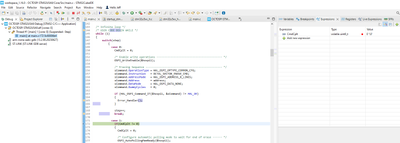

Could you please place a breakpoint in main.c after HAL_OSPI_CmdCpltCallback function and click on resumeKDJEM1_0-1726043661225.pngand check if CmdCplt change value or not?
void HAL_OSPI_CmdCpltCallback(OSPI_HandleTypeDef *hospi)
  CmdCplt++;
 On my side I see that the value of CmpCplt changes from 0 to 1 as shown in the below figures

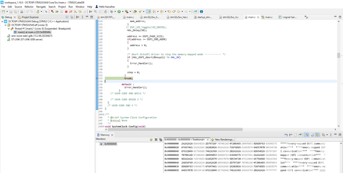

To check the memory content, could you please set a break point after reading sequence. As shown in the below figure you can say the same content as in aTxBuffer[]

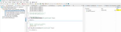

Hello Kaouthar,
CmdCplt value can be changed on HAL_OSPI_CmdCpltCallback function as below picture.
However, it becomes zero in the switch(step) loop when the step is 1. But sometimes CmdCplt becomes 1 when the step is 1. I don't know why the result is not consistent. Even when the step 1 code is executed, the printf doesn't print the flash memory data. Although I enabled UART by the pinout configuration like the old project, it seems UART is not working. The slightly modified OCTOSPI STR project is compressed and attached.

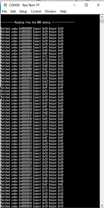

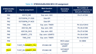

After checking your project, I noted that you use a wrong USART.
Could you please try with USART1 pin PA9 and pin PA10 as shown in the below figure (UM2967)
This is a screenshot of terminal with matched index:
