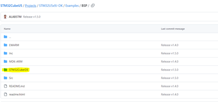

You can run the BSP example by open this example using STM32CubeIDE toolchain. Please take a look at UM2609.

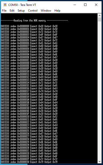

Hi Kaouthar,
I imported the project but it can't be compiled as below. How to solve those errors?

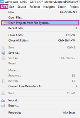

Then, please try to open the OSPI example by following these steps:

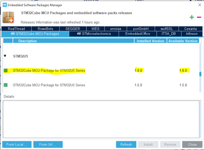

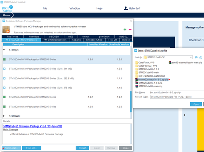

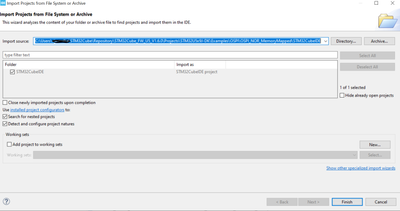

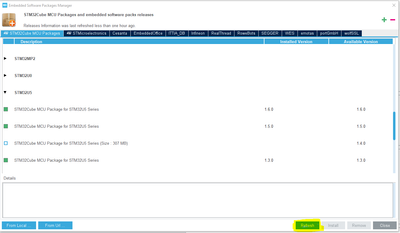

The embedded software packages manager shows that the 1.3.0 STM32Cube MCU Package for STM32U5 is installed. I tried to install 1.6.0 from the local directory as below. It alerted "this package version is already available on current STM32CubeMX repository.". Is it fine? I opened the OSPI_NOR_MemoryMapped project again from file system. The compilation still has the same error message. The ioc file of the original project is attached for the OSPI configuration. The new project OSPI_NOR_MemoryMapped doesn't have the ioc file.
Best Regards,
Jeff

Hello @JKim.2,
Please use the latest STM32CubeMX version 6.12.0 and click on Refresh button to see the latest version of STM32CubeU5 firmware
I advise you to delete all STM32CubeU5 firmware versions and to redownload again using STM32CubeMx or from this link STM32CubeU5 - STM32Cube MCU Package for STM32U5 series (HAL, Low-Layer APIs and CMSIS, USB, File system, RTOS, TF-M - coming with examples running on ST boards) - STMicroelectronics .
If you want to use GitHUB please take a look at this post.

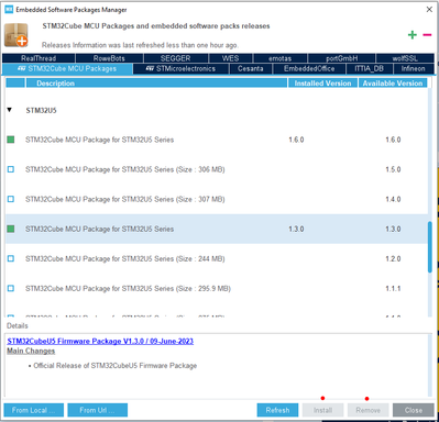

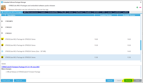

I installed the latest STM32CubeMX version 6.12.0 as you suggested. btw, both remove and install button on STM32CubeMX are disabled as below? How to remove all the MCU Package for STM32U5 Series?

KDJEM.1
Hi @JKim.2 ,
Click on STM32Cube MCU Package for STM32U5 Series to enable remove button. Then, click on Remove.
To install the latest version click on STM32Cube MCU package for STM32U5 series 1.6.0 version. Then, click on Install.
