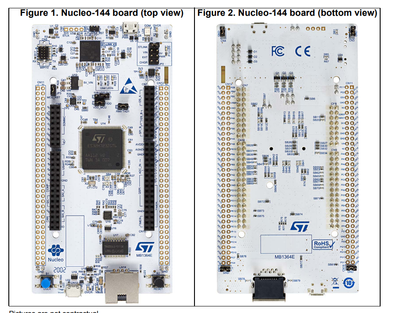

hello, could you please tell me where the default jumper wires be placed on the board h743zi2. quick response is much appreciated as i am in a hurry with the deadline. pictures of the board are much needed while answering.
2024-09-13 2:19 AM - edited 2024-09-13 2:25 AM
There are no jumpers on the bottom. Only solder bridges.
The only jumpers on the bottom are connected on GNDs connectors as "spare" jumpers for future use.
From the user manual of the board (Figure 1 and 2):
In any case, you need to check the user manual of the board for each default position: jumpers and solder bridges.

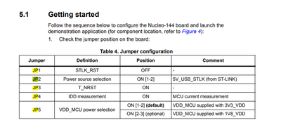

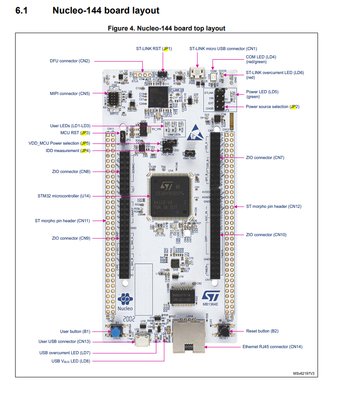

2024-09-13 2:05 AM
Hello @suhfi
You need to follow this getting started table:
together with the board picture:
Best Regards.

2024-09-13 2:09 AM - edited 2024-09-13 2:16 AM
okay, thank you for response.
it would be more appreciated when you send the photo of the back view also of the board. The problem is i am not sure if i dropped some jumpers or not.
