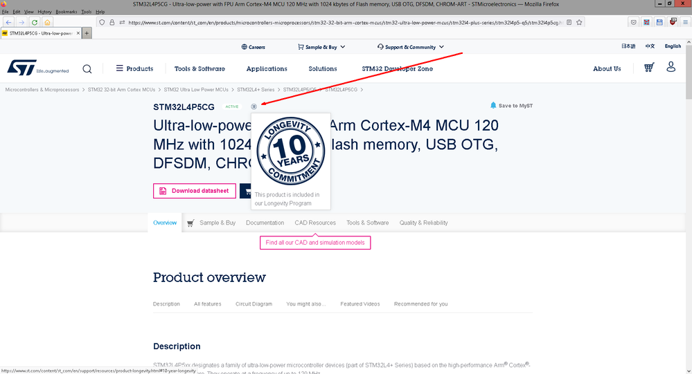

2023-01-19 11:51 AM
Thanks! I suggest making that symbol more prominent. It's barely readable on my 24" display.
