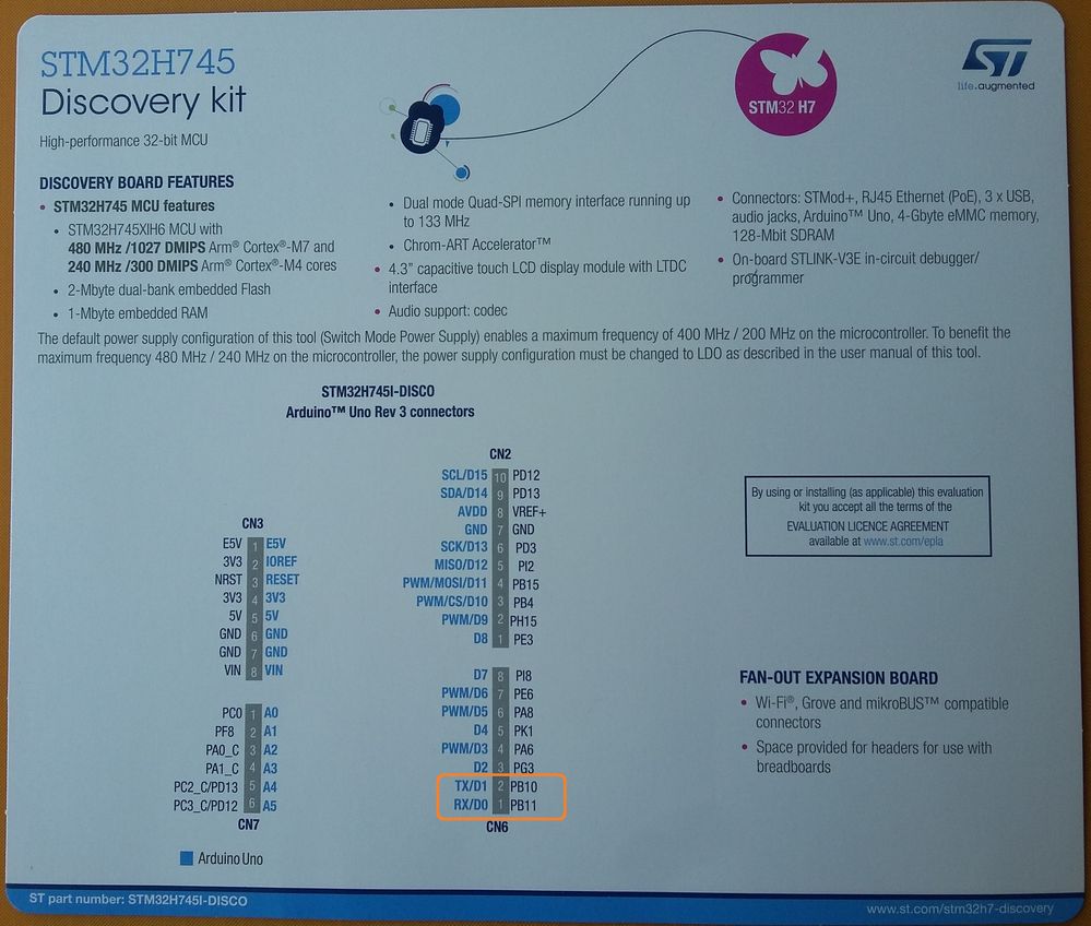

The schematic and insert card disagree.
The VCP is USART3 PB10/PB11 (verified)
The Arduino header D0/D1 is PB7/PB6 USART1
UM2488 described in the data brief is also missing
https://www.st.com/resource/en/user_manual/DM00547983.pdf
https://www.st.com/resource/en/data_brief/stm32h750b-dk.pdf

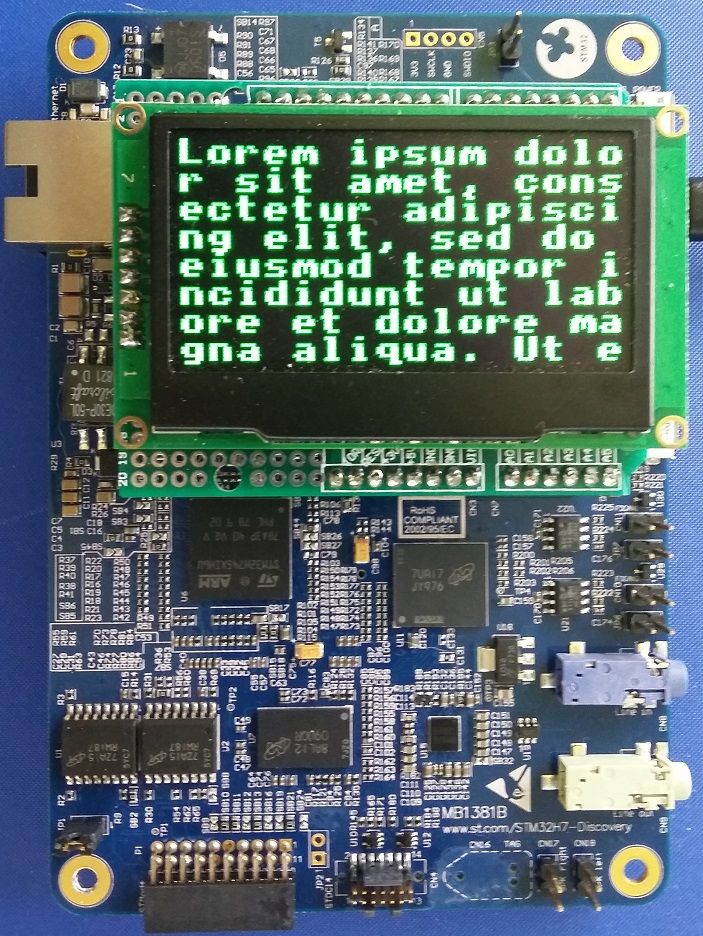

I2C works (I2C4 PD12/PD13)

Hi @Community member ,
I am checking your very first input, it seems to be an error on the user manual and its schematic that was propagated to the flyer of the board.
I'll report this internally to take relevant corrective actions.
Thanks for highlighting it.
