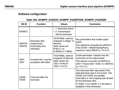

Hello @Kamurasi-Jordan-Arthur and welcome to the community;
Are you using STM32N6570-DK board? If so, what is the revision of the board?
For more information about the Downsize information, I recommend you to look at RM0486 Rev 2 Section 39.7.4 Downsize.
I hope this help you.
