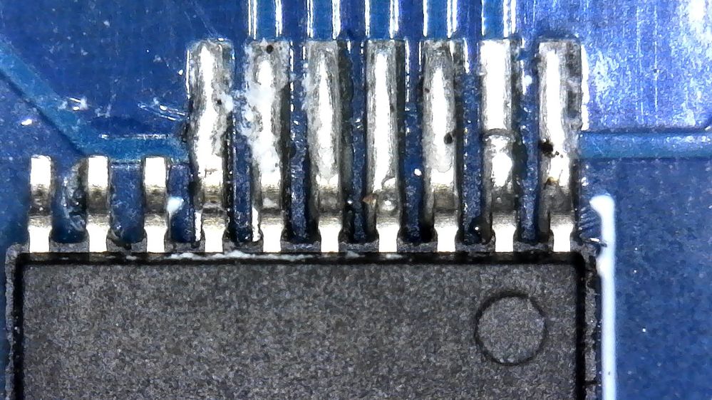

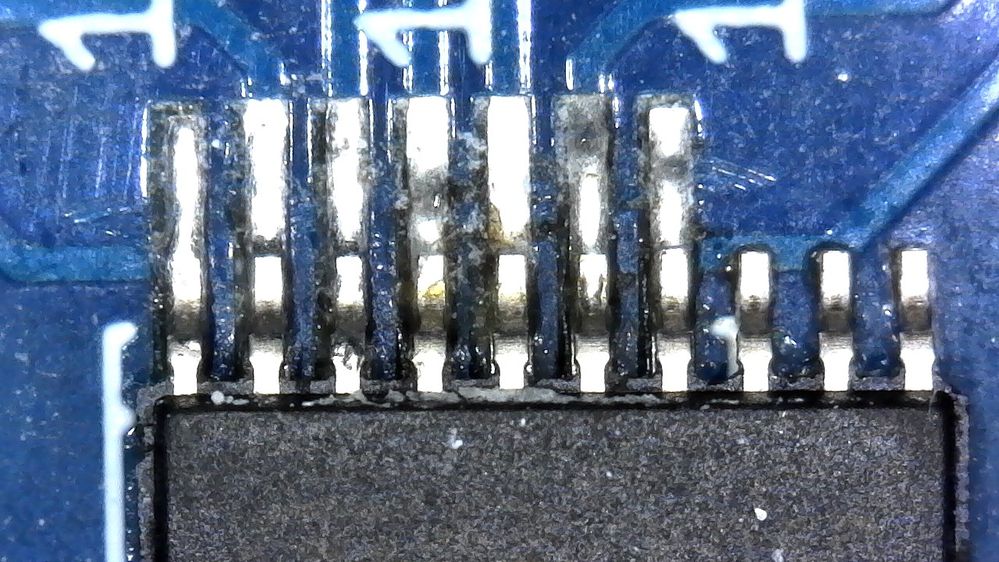

2022-03-22 12:43 AM
These are supposed to be "virgin" devices, not preprogramed?
If you're sure power supply and wiring to STLink is ok then devices are definitely broken. Could you attach photos of top side of one? Maybe from different viewing angles, so reflection of surface could be evaluated?

2022-03-22 8:25 PM
These are the pics of my breakout board. I only had a 14 pin board but it is sufficient for the pins I need.
