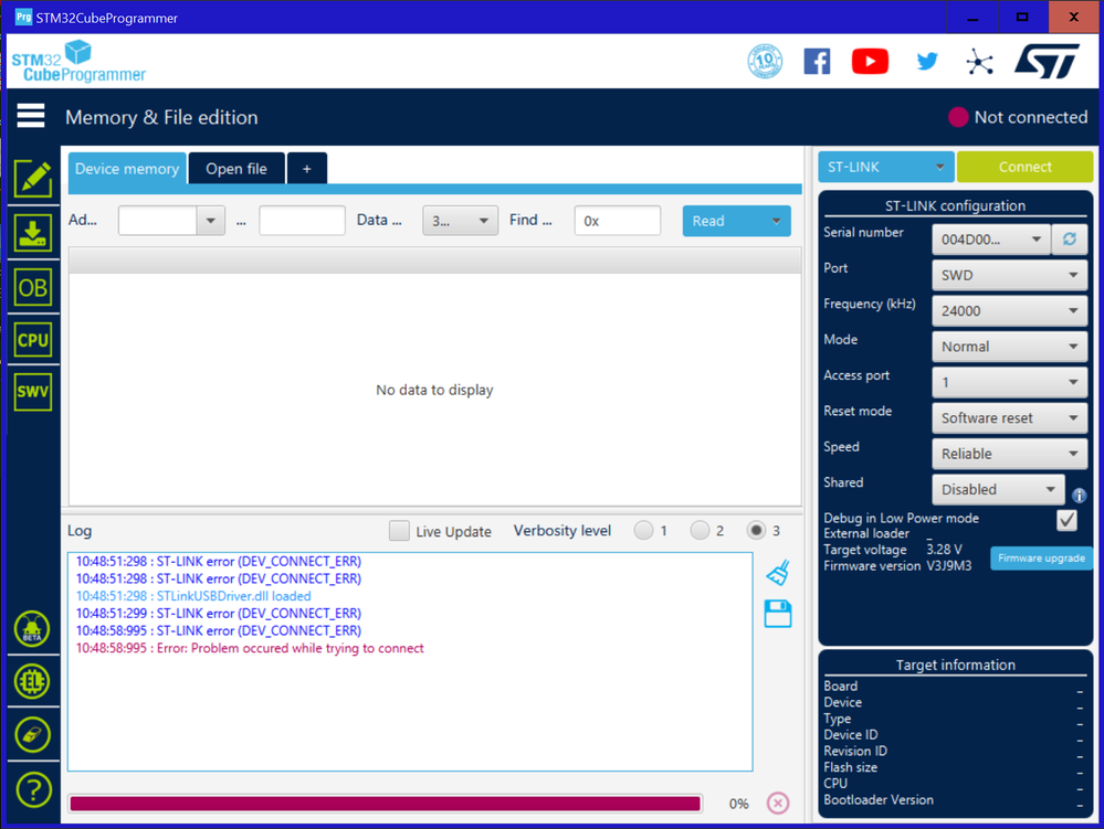

I have three STM32H7B3IDK
They all have different serial numbers.
I am running two boards OK one on the old STMStudio gathering data the other connected to CubeIDE.
I can connect the third and can scan for it in CubeIDE and CubeProgrammer, but when I try to connect i get a connection errror.
When I try to debug the third board in CubeIDE I get:
Dialog Box:
Error in final launch sequence:
Failed to start GDB server
Error in initializing ST-LINK device.
Reason: (0) Unknown. Please check power and cabling to target.
Console:
Starting server with the following options:
Persistent Mode : Disabled
Logging Level : 1
Listen Port Number : 61234
Status Refresh Delay : 15s
Verbose Mode : Disabled
SWD Debug : Enabled
InitWhile : Enabled
Failed to bind to port 61235, error code -1: No error
Failure starting SWV server on TCP port: 61235
Failed to bind to port 61234, error code -1: No error
Failure starting GDB server: TCP port 61234 not available.
Shutting down...
Exit.
I can connect, program and update the ST-Link firmware on all of the boards, but when a third one is plugged in I can update its firmware, but not connect to it.
I have tried three different USB ports and two different USB cables. All with the same result.
When I plug the third board in the comm port gets activated and the file explorer opens showing the MBED.HTM and DETAILS.TXT.
I am running IDE 1.9.0 and Programmer 2.10.0.
Is there a limit on the number of connections you can have or is this some sort of problem.
I often have two boards connected; one undergoing a production test, the other being used for development. I think? this is the first time I've tried three boards.
Regards
Rob
2022-03-18 6:16 PM
The problem turned out to be STMStudio. I had this running on a Disco. board. STMStudio doesn't seem to cooperate with the latest drivers/software. It also prevented the Programmer from connecting to targets.
