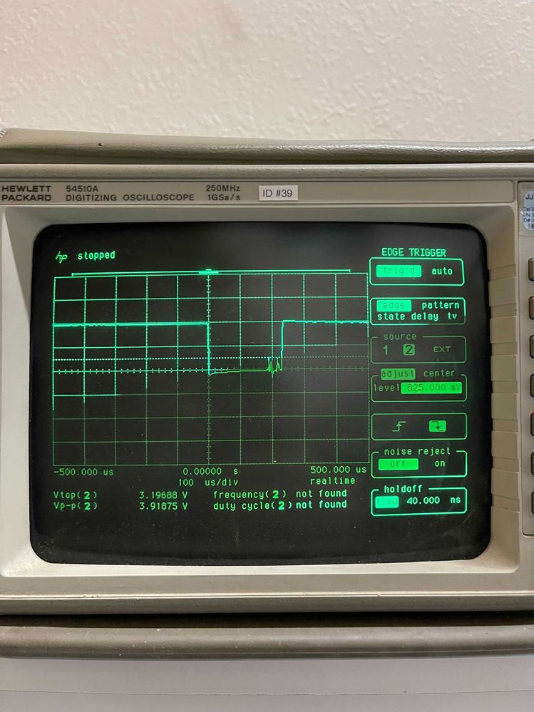

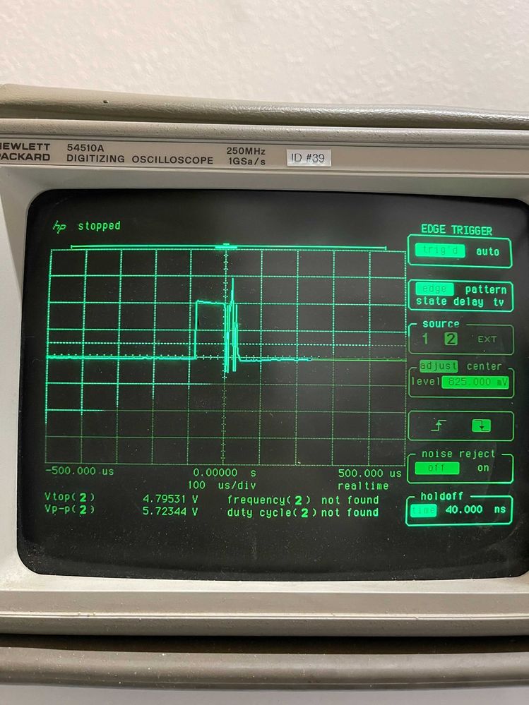

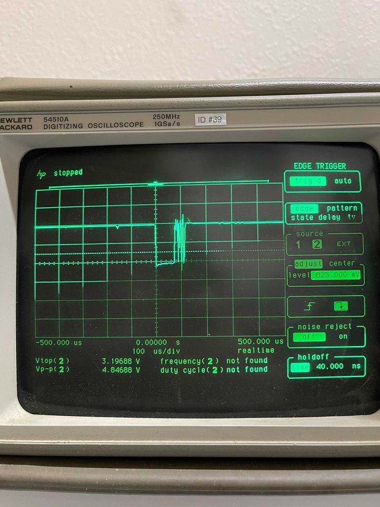

Reason: (4) No device found on target.We've verified that the target is powered and looked at the signal's coming out of the STLink.
SWDIO:
SWCLK:
RST:
I'm not exactly sure what these are supposed to look like, so any comment would be appreciated. I know the programmer works with the other boards so I assume they are correct.

Hmm. Since you have experience with the G070 there should be not much differences. The TSSOP20 package is new for you, right?
Connect under Reset, otherwise the "empty check" may switch to system boot mode which might use the pins for own purposes.
The SWD connect will start with a line reset whicht is 56 (?) SWCLK toggles while SDWIO high. Don't see that in the pictures. Maybe a LA helps here.

2022-03-18 11:55 PM
Sorry, a logic analyzer. There are even cheap ones ($10, USB connector) with a software that can decode the SWD protocol. You don't have to understand the protocol details, but you see if there are protocol errors, much better that in the above scope screen dumps. In addition, lowering SWD speed might help.
