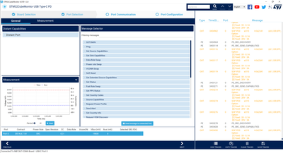

After plugging in my STUSB4500 sink board, there is no negotiation completed. The source is able to send out it's power delivery capabilities, but no messages are received from the sink in the traces of STM32CubeMonitor.

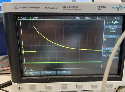

11894 On the oscilloscope, the sink board gets a 20V spike that then decreases since the power delivery negotiation never finishes.

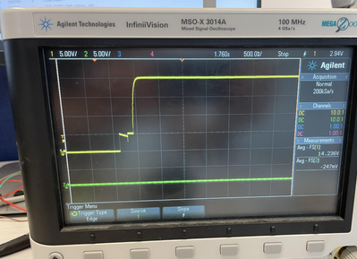

I do not think this is a sink issue as connecting the sink to a USB-C Dewalt charging power brick that delivers 65W can provide a sustained 20V after 5V. The negotiation seems to complete itself.

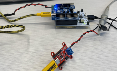

Hardware Setup:

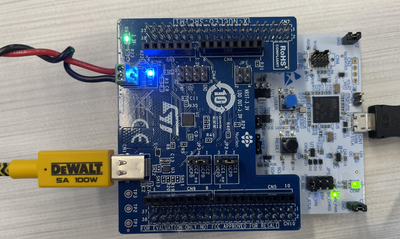

I've connected a 20V supply to CN3 of the SRC1M1 board and validated 20V is going into the terminal. A USB-C power cable is connecting CN1 to the Sparkfun power delivery sink board. A Micro-USB cable connects the STM32 NUCLEO-G0B1RE MCU to my computer to view debug logs. I connected the oscilloscope probes to the output power terminals of the sink board.

I think your setup on SRC side would need to be able to provide 5V first, then after negotiation something else (20V for example). If you look at oscilloscope plot when facing USB-C Dewalt charging power brick, you see that after PD port is connected from SRC side, 5V is provided as VBUS.
At this stage, SRC capa are sent, and SNK side could request something else than 5V.
When negotiated, then SRC could provide 20V, not from start.
I think that what is happening in your case, is that when SNK Rd are detected from SRC side, VBUS is provided by configuring TCCP02 Provider Gate (on SRC1M1 shield). As 20V are supplied on CN3, 20V are provided on VBUS. I assume that SNK side enters in security mode, as only expecting 5V at this stage.

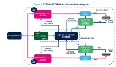

STEVAL-2TPD01, USB Type-C Power Delivery dual port adapter based on programmable buck converter (60W for each port), documentation is available on web on documentation tab. User manual details technical behavior while the Quick Start Guide provides a kit overview + basic setup & programming.
Below, documentation extract shows architecture block diagram with main part numbers to performs key functions (DC/DCs, MCU, HV interfaces and protections) and links between them.
SW and HW resources are also available.
