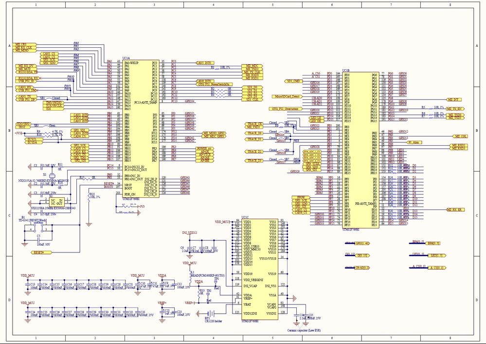

2021-09-03 9:57 PM
I have attached the schematic for MCU. I am using external stable power supply for test purpose so I have not included the power section.
2021-09-03 10:34 PM
VDD12DSI connected to VDD_MCU doesn't look right.

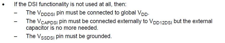

2021-09-03 10:45 PM
According to the datasheet page 29, if DSI is not used, then VDD12DSI must be connected to VDD:
2021-09-03 10:52 PM
No, it says VDDDSI must be connected to VDD.
It says VDD12DSI must be connected to VCAPDSI.
VDDDSI (pin 118) and VDD12DSI (pin 125) are different pins.
2021-09-04 12:26 AM
Yes you are right... I have fixed it and everything seems to be ok now.
