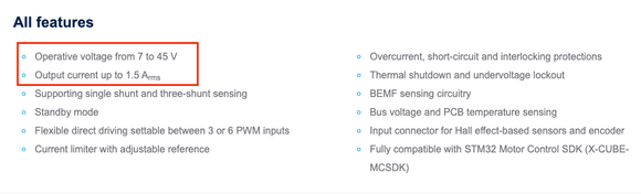

I am currently evaluating the X-NUCLEO-IHM16M1 motor control expansion board and would like to ask whether it is suitable for measuring the electrical parameters of the motor described below.

According to the X-NUCLEO-IHM16M1 documentation, the maximum output current is specified as 1.5 A RMS.

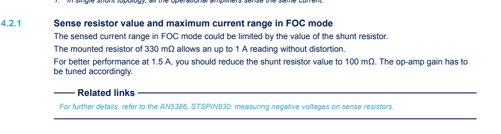

Refer to the "4.2 Current sensing" chapter of the X-NUCLEO-IHM16M1 user manual document.
You can profile your motor with an Imax value and modify it in the resulting JSON file to set the actual maximum current of the motor.

According to the documentation, changing the shunt resistor from 330 mΩ to 100 mΩ increases the measurable current range from 1 A to 1.5 A.
However, the datasheet specifies the output current as 1.5 A RMS.
Does this mean that the device can actually reach 1.5 A RMS only when the shunt resistor is changed, and that with the default 330 mΩ shunt resistor the usable current range is limited to around 1 A?

Finally, I would like to understand why the current range is limited to 1 A when using a 330 mΩ shunt resistor.
Is this limitation due to the maximum allowable shunt voltage, ADC input range, or current-sense amplifier saturation, rather than the output stage capability itself?
2026-01-19 7:11 AM
Hello @pelino,
As mentioned in the documentation: The mounted resistor of 330 mΩ allows an up to 1 A reading without distortion. It is not mentioned that is an absolute maximum value.

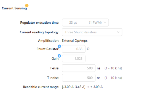

In MCSDK, the current can be detected in the Current Sense block as shown below, and the maximum value is indicated as 3.09 A.
However, I do not clearly understand why the datasheet specifies the current as 1 A.
