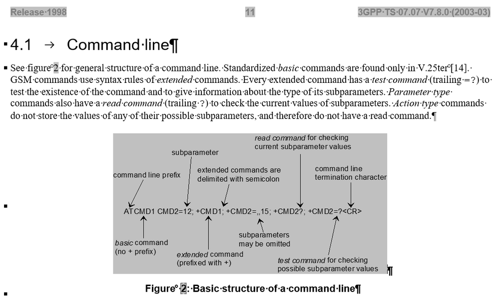

@Mike_ST wrote:Check whether your module expects "\r\n" or just "\n" at the end of each AT command.
The AT command terminator should be just CR.

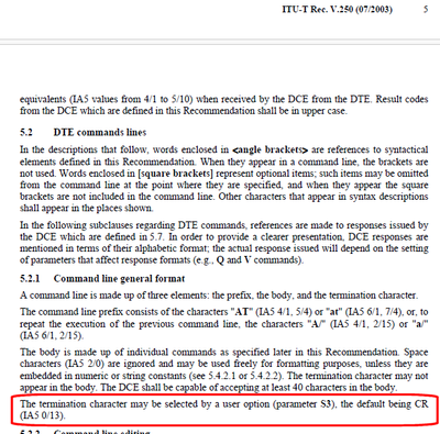

@liaifat85 wrote:Try sending simple AT commands like AT\r\n .
The command terminator is just CR:
https://portal.3gpp.org/desktopmodules/Specifications/SpecificationDetails.aspx?specificationId=323
https://www.itu.int/rec/T-REC-V.250 (supersedes the https://www.itu.int/rec/T-REC-V.25ter referenced in GSM07.07)

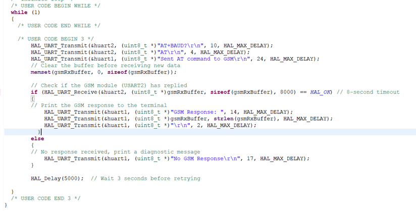

First in order to debug, I tried manually testing USART communication separately:
* I've separately tried USART communication between PC terminal and STM32 board- it works,
* Separately tried communication between GSM Module and Arduino-it works.
The GND of both the STM32 and GSM has been connected commonly.
the GSM is still not responding to the AT commands, I sent a simple AT command for which the module is supposed to reply with OK but it is not doing so.
Code:
Is there anything I could be doing wrong? What can i try to do now

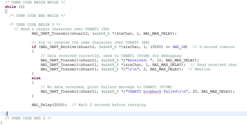

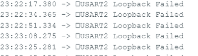

2024-09-06 11:00 AM
I tried another debugging, I connected PD5(which is the USART2 Tx) to PD6(Rx) directly and tried a loopback test just to see if the channel is working.....it is not, the loopback test itself fails..
so i think the mistake is in the configuration and initialization itself,
but I can not tell what is wrong with the configurations, everything seems to be correct.
