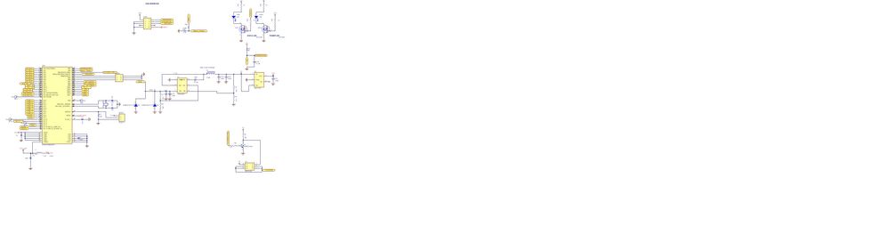

@FJB2069 wrote:Custom board will not run without debugger.
Then you'll need to post the schematic

2025-04-15 3:11 PM
BOOT0 with a local 10K pull-down looks Ok. What do you mean use as Output?
With a single VCAP I think expectations is for 4.7uF, not 2.2uF

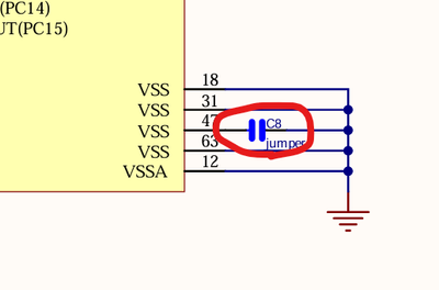

2025-04-15 3:17 PM
Why is C8 here?
VSS should be connected directly to ground.
Otherwise seems okay-ish. Should have 0.1 uF decoupling cap on each VDD pin. Unlikely to prevent it from booting.
Voltage at PB0 may be a problem. If using the ADC, voltages above VDDA are not allowed. Included schematic is missing details.
