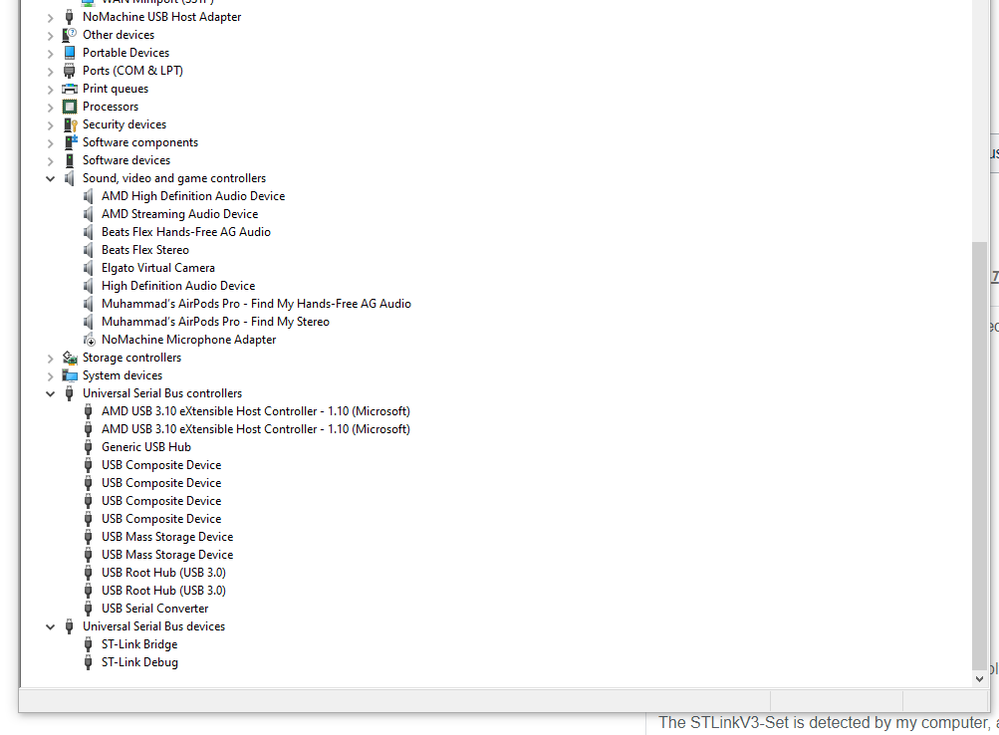

The STLinkV3-Set is detected by my computer, as seen in the following image.
