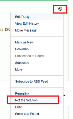

Somehow this post has switched to 'solved' but this has not been solved. How can i remove the 'solved' ?
Kind regards
2025-01-20 12:52 AM
Can some admin please reset the 'solved' from this post? The problem was not solved and i don't know why it switch to solved.
2025-01-20 12:55 AM
You can do it yourself:
2025-01-20 12:57 AM - edited 2025-01-20 12:58 AM
Thank you! fixed the 'solved' state of this post...

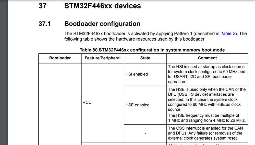

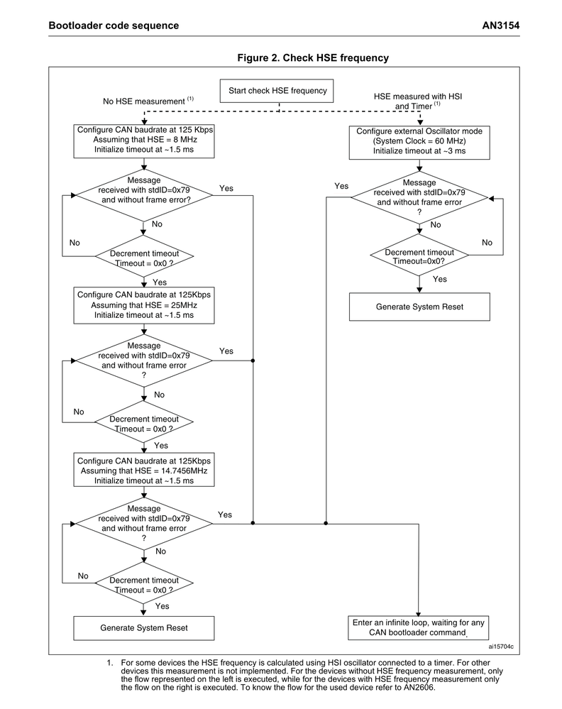

AN3154 Application note
Have you studied this document?
Do you have an external quartz resonator, if so, what frequency?
2025-01-20 8:42 AM
Hi, i don't have an oscillator on the F446 at the moment. I have seen the document but i had the impression it would still run without external oscillator..
Are you suggesting i need an external oscillator for the bootloader to work over CAN ?
Thats not easy to test for me at the moment as it requires a new pcb, but if that's the issue then the way forward is clear.
2025-01-20 11:52 AM
CSTNE8M00G55Z000R0
8 MHz Ceramic Resonator Built in Capacitor 33 pF ±0.2% 40 Ohms -40°C ~ 125°C
Already contains compensation capacitors
