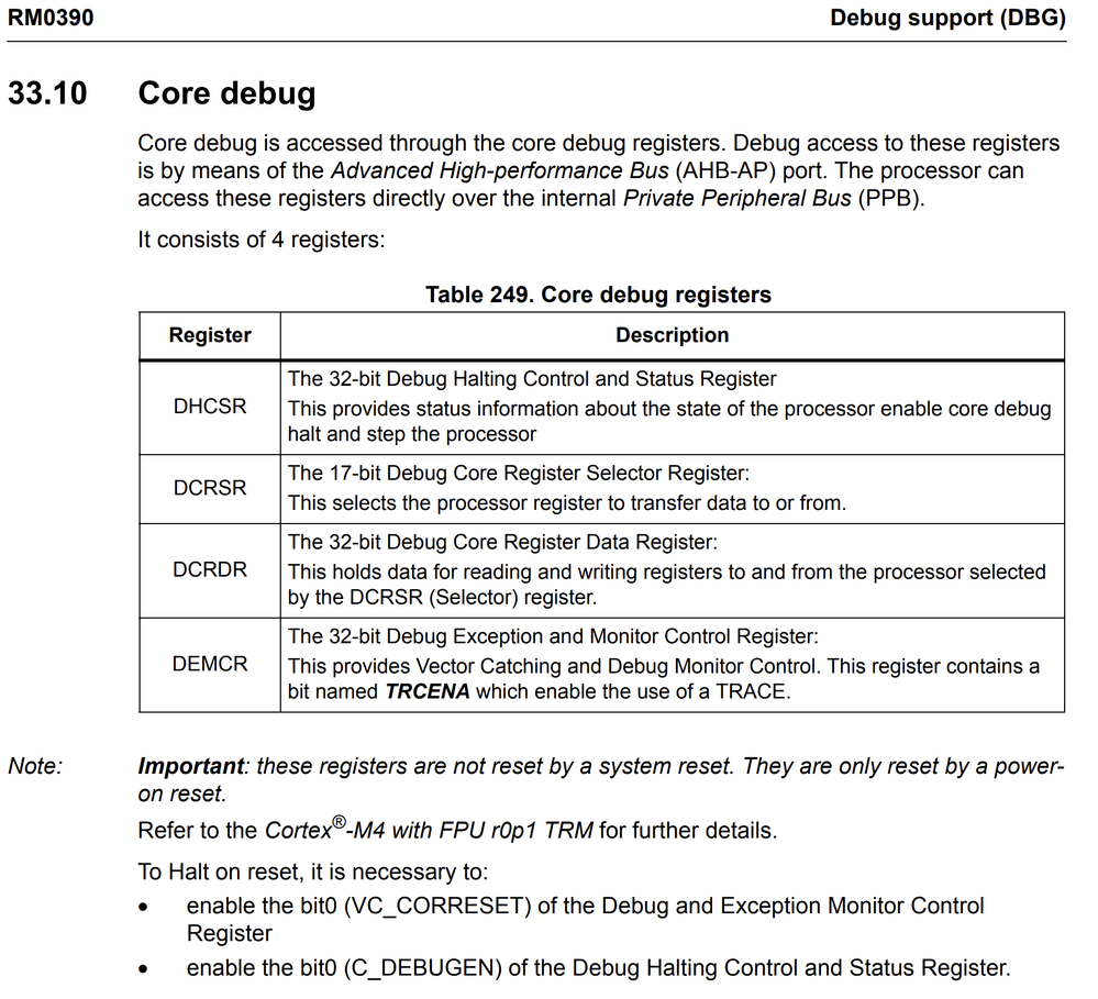

I have been through all the Options for Target, checking to see if I need to turn something on etc. Been looking at this for a few hours now, and also Googled CoreDebug etc and found the reference in the
I have checked that they exist in this micro in the STM32f446 reference manual:
Tearing my hear out over what should be something very simple that I am not seeing!

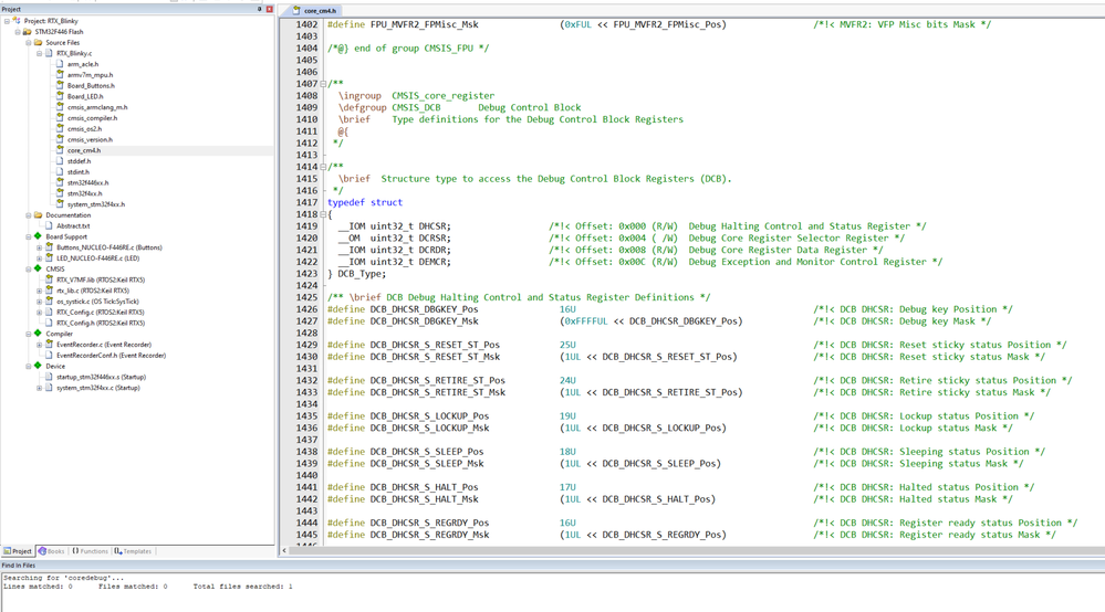

Thank you for your response TDK. I do have core_cm4.h...
But it does not include 'CoreDebug' - I can see the register definitions, but different from the code sample I posed above, and as what is used in EventRecorder.c :
if( CoreDebug->DHCSR & CoreDebug_DHCSR_C_DEBUGEN_Msk )
Where as in my core_cm4 I have the debug enable mask defined as:
#define DCB_DHCSR_C_DEBUGEN_Pos 0U /*!< DCB DHCSR: Debug enable control Position */
#define DCB_DHCSR_C_DEBUGEN_Msk (1UL /*<< DCB_DHCSR_C_DEBUGEN_Pos*/) /*!< DCB DHCSR: Debug enable control Mask */
so the core_cm4.h that I have is not using the 'CoreDebug...' syntax that is being used by EventRecorder.c. I searched for @CoreDebug' in the core_cm4.h file, there were no matches, as can be seen in the above screenshot.
Thanks for any help you can give, I am tearing what's left of my hair out!

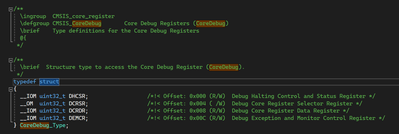

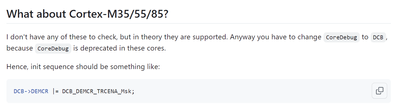

2024-01-08 8:01 AM
Also just found this relating to different cores:
But should I change my readonly files EventRecorder.c? I am not sure how you even go about changing a readonly file, do I have to do it outside the IDE?

C:\Users\cider\AppData\Local\Arm\Packs\ARM\CMSIS\5.9.0\CMSIS\Core\Include\core_cm4.h from CMSIS 5.9 contains:
So it seems that Arm/Keil are moving from CoreDebug to DCB from thier move from CMSIS 5.9 to 6, but the EventRecorder.c is still looking for CoreDebug!
