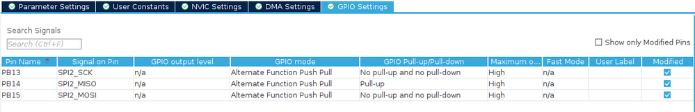

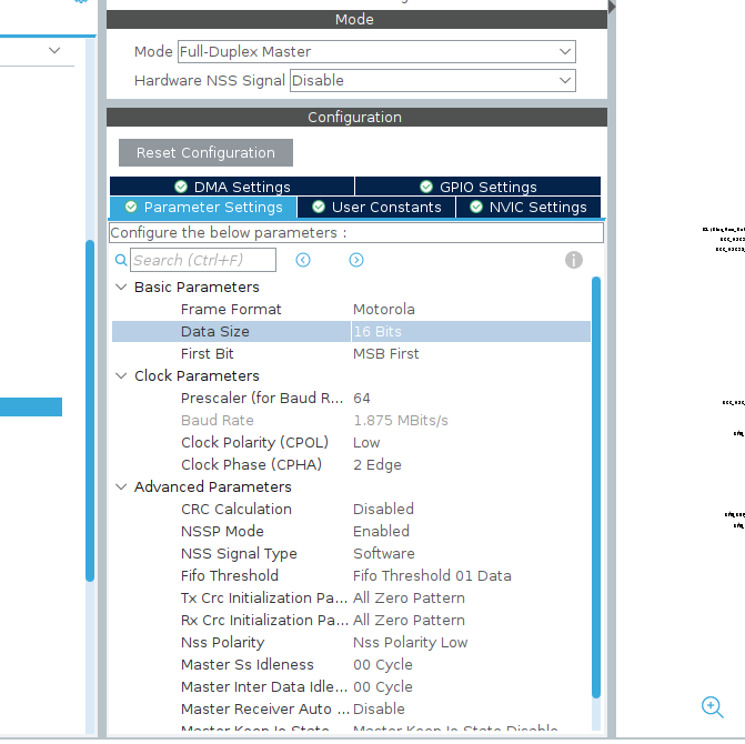

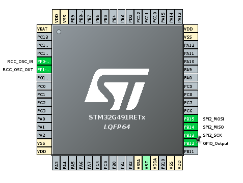

Hi Community, I recently worked on SPI in mode 1 and observed some miscellaneous behavior. Can anyone please confirm the configurations made to work with mode 1 are proper?
And when I use Hardware NSS Signal to Hardware NSS Output Signal there is no proper signaling (high at idle low when sending data) on SPI2_NSS even after setting pull-up in the GPIO Settings. So setting it up as GPIO_Output and controlling manually.
Please find the sample test code below

It is mentioned in the stm32g4xx_hal_spi.h that SPI_NSS signal will be enabled only if CPHA = 0. But in my case, it is 1. So why can't NSS isn't going to work in this case?

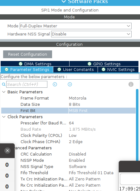

Can you please share the SPI settings you set for mode1 (CPOL=0;CPHA=1). I'm not able to identify the issue because of which I'm not able to communicate with SPI slave.

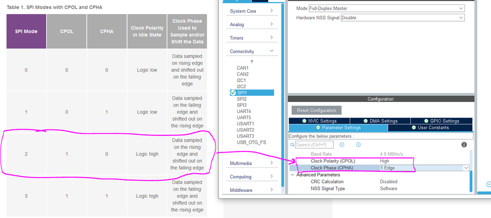

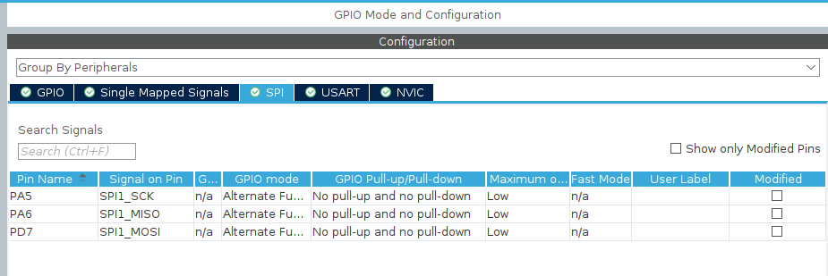

I'm using STM32H723 with a SPI slave AD5293 (digital pot). AD5293 follows SPI protocol with CPOL=0;CPHA=1. Here is the screenshot of my SPI settings in CubeMX.
Note: I referenced the settings from another answer from STM forum where I found the following image -

Hi @bruce_wayne_1997 the following configuration worked well for me with AD5592 SPI on CubeMX.
| Data Size | 8 Bits |
| CPOL | LOW |
| CPHA | 2 Edge |
Use HAL_SPI_TransmitReceive and probe the SPI on the oscilloscope/analyzer.

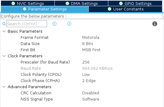

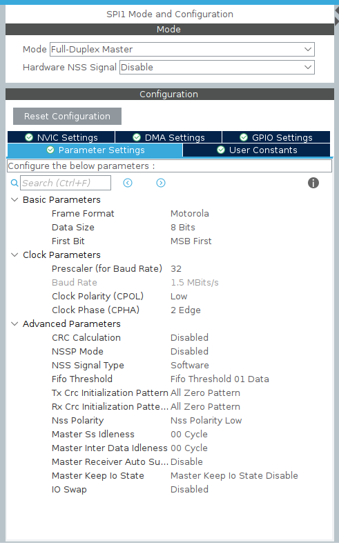

2024-04-25 4:43 AM - edited 2024-04-25 4:44 AM
Hey @newbie_stm32 ,
I changed the cubemx configuration to CPOL=low;CPHA=2 Edge as I understood from your reply.
Picture:
I adjusted the code to the following after your suggestion:

Hello @newbie_stm32,
I have followed your suggestions on changed I need to make to transfer the data to AD5293 chip.
First I'd like to share my SPI configuration again: (Figure 1)
Sharing the SPI GPIO config: (Figure 2)

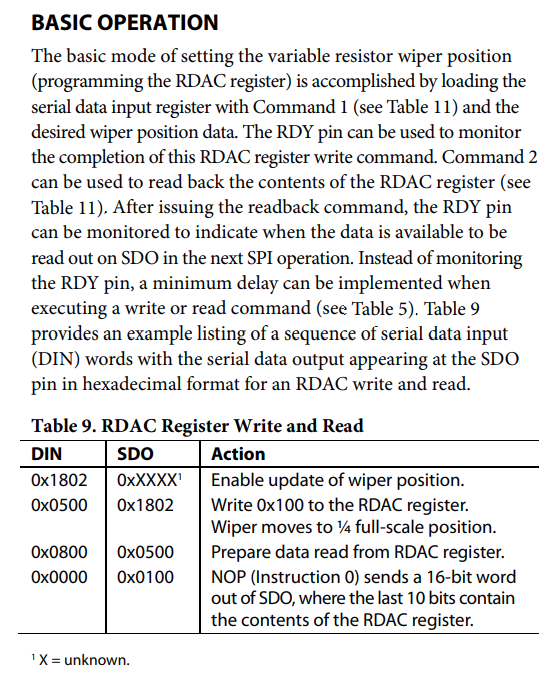

Code used to send data to AD5293: (followed "Basic Operation" table from the datasheet) (Code 1)

HAL_GPIO_WritePin(GPIOB, AD5293_CS_Pin, GPIO_PIN_RESET);
// Transfer 0x1802
spi_tx_buf[0] = 0x02;
spi_tx_buf[1] = 0x18;
if(HAL_SPI_Transmit(&hspi1, spi_tx_buf, 2, 0xFF) != HAL_OK)
printf("SPI transmit failed\r\n");
// Make CS high
HAL_GPIO_WritePin(GPIOB, AD5293_CS_Pin, GPIO_PIN_SET);
// Make CS low
// Transfer 0x0500
spi_tx_buf[0] = 0x00;
spi_tx_buf[1] = 0x05;
if(HAL_SPI_TransmitReceive(&hspi1, spi_tx_buf, spi_rx_buf, 2, 0xFF) != HAL_OK)
printf("SPI transmit receive failed\r\n");
// Make CS high
HAL_GPIO_WritePin(GPIOB, AD5293_CS_Pin, GPIO_PIN_SET);I'm not able to receive anything on spi_rx_buf[2]. I concluded this using debug mode after line 27 from the code above. I believe this is happening because my SPI on the STM is not working properly - the SCLK line.

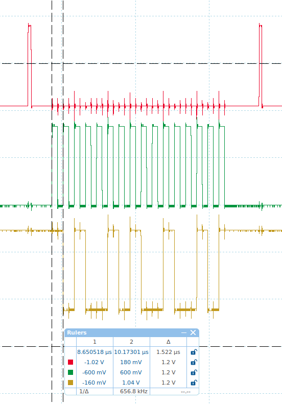

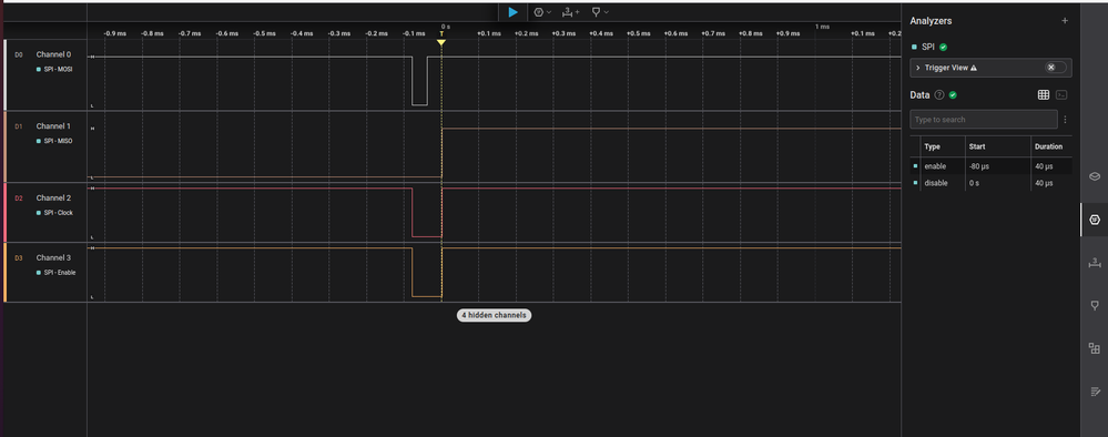

Sharing the Oscilloscope data: (oscilloscope is 24MHz, 8ch): (Figure 3)
As you can see, the clock line is only changing once, the SPI data is not being transferred to the slave.
Sharing the SPI initialization code generated by Device configurator: (Code 2)
SPI Config: SPI Mode 1 (CPOL=0;CPHA=1), 8 bits, MSB first

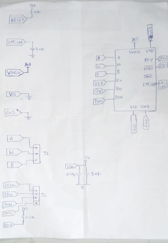

Although the slave is not the problem I'd like to share the schematics of AD5293 circuit I made for more clarity.
Is this correct?
