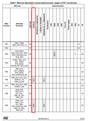

@mbedsyst wrote:The problem I am facing is, the I2C_SCL for the CS43L22 is mapped to the PB6 of the STM32F411VET6
That shouldn't be a problem - that is the documented design:
If the I2C connection to the audio DAC (CS43L22) isn't working, then you need to debug what's wrong.

I wasn't pointing to the fact that PB6 being mapped to the CS43's SCL is my problem, I was saying that I couldn't get the PB6 to function as SCL but PB8 works fine. I tried writing and reading the EEPROM with PB8 as I2C1_SCL and it worked fine. Since the CS43 is connected to PB6, I wanted to make sure the SCL works, so I tried with the EEPROM, but it failed.
