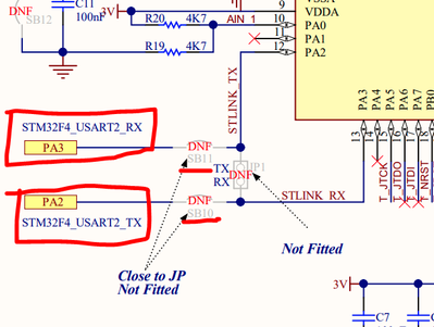

This is an older board that doesn't have the VCP functionality with modification, but you can close SB10 and SB11 to get it. Then, it will be available on USART2 (PA2/PA3).
The VCP would be available on the same USB connector as the st-link (CN1).

I don't think so. According to UM and also the schematics even for rev.D, the STLink is V2 (STM32F103C8T6), i.e. not V2-1, i.e. it does not have VCP.

You can't. You need either some external USB-to-UART converter, or some different board (e.g. Nucleo) which does have the newer STLinkV2-1, which supports VCP.

@waclawek.jan I have a USB TTL 232 cable and i tried connecting in to PB6 and PB9, it won’t detect my board, where should i connect the USB TTL cable? PA2 and PA3? In the user manual it does not state anything regarding this.
