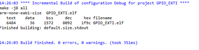

Hello @mystar411;
Are you downloading STM32Cube packages from GitHub? if yes, please look at this FAQ to avoid the compilation errors.
Alternatively, you can download our packages directly from ST.com by using the link below:
https://www.st.com/en/embedded-software/stm32cube-mcu-mpu-packages/products.html.
I'm not able to reproduce your issue. For my side the GPIO_EXTI is built without error.
May this post can help you to solve the "fatal error: core_cm4.h: No such file or directory" error.
I hope this help you.
Thank you.
Kaouthar

2025-04-09 6:57 PM
I run it in Tab Example Selector on CubeIDE with Discovery Board Completely. Its OK. Thanks for your help!
