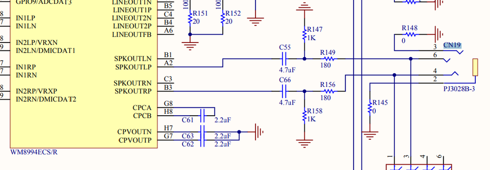

CN19 connects direct to the WM8994ECS/R audio CODEC:
Have you checked the CODEC datasheet to see if that output is suitable for an 8-ohm speaker?

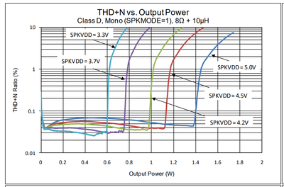

The WM8994's speaker output is configured as Mono mode by SPKMODE pin connected to GND. so you may refer to Speaker driver performance mentioned in the WM8994 datasheet to justify if it's enough to power your speaker.
R149 & R156 being 180R is NOT good news for an 8ohm speaker, regardless of what the data says...
