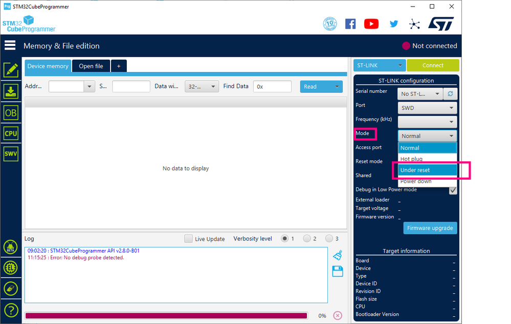

Hi @FSkro.1 ,
Can you please try to connect under reset and tell me if it is Ok?
Houda

2021-06-22 6:08 AM
Under reset or in power down mode I get the following:
09:06:08 : ST-LINK SN : 0035002E3438510534313939
09:06:08 : ST-LINK FW : V3J7M2
09:06:08 : Board : STM32H7B3I-DK
09:06:08 : Voltage : 3.28V
09:06:09 : ST-LINK error (DEV_CONNECT_ERR)
09:06:09 : ST-LINK SN : 0035002E3438510534313939
09:06:09 : ST-LINK FW : V3J7M2
09:06:09 : Board : STM32H7B3I-DK
09:06:09 : Voltage : 3.28V
09:06:10 : Error: ST-LINK error (DEV_CONNECT_ERR)
