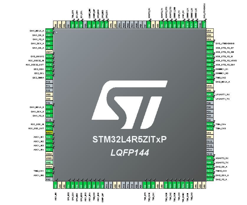

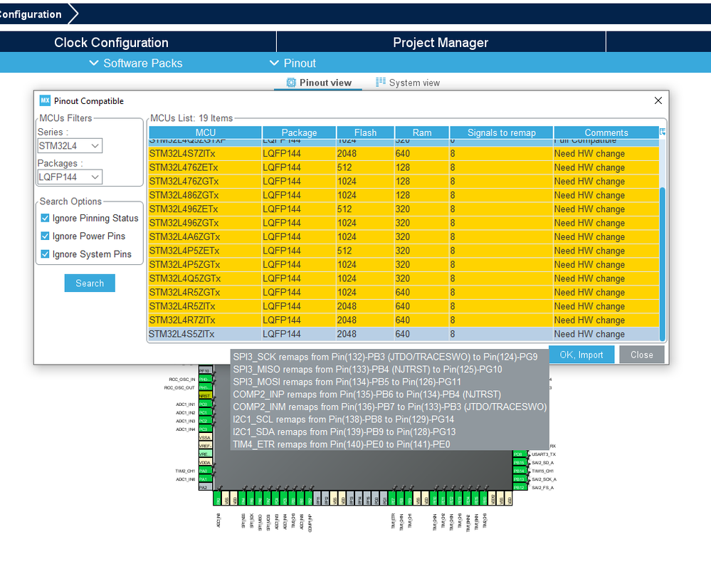

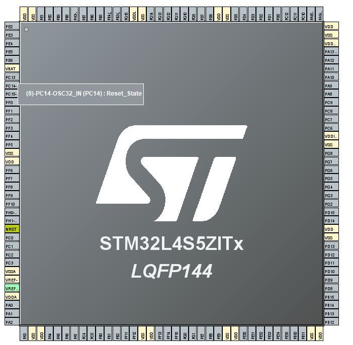

Also, you need to check the pins to use, as you can see in the below screenshots, there is a difference in the pinout and the hardware need change.
0693W00000BbaZjQAJ.jpg 0693W00000BbaZtQAJ.jpg0693W00000BbakcQAB.pngYou can use the "List Pinout Compatible MCUs" feature in STM32CubeMX, this will help to identify the difference.
