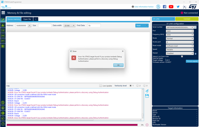

Having trouble connecting to ST-Link Utility. Cannot connect to target keep popping up.

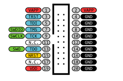

I followed this pinout to connect to the MCU
I connected the following. SWDIO to TP3, SWCLK toTP2, NRST to TP4 then VCC and Ground. I already double check connection and tried different board and I still can`t connect.

2024-04-24 11:57 PM
Its having the same problem
