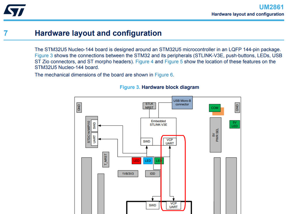

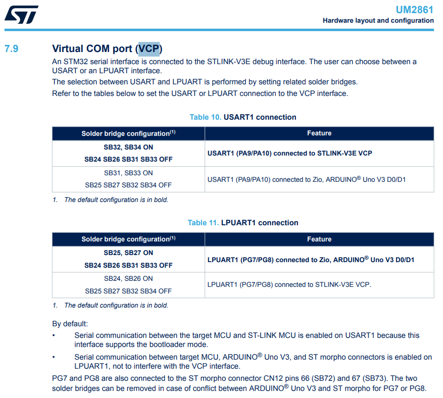

2025-05-29 6:15 AM
@SMusc.1 wrote:VCP is the com serial port of laptop right?
"VCP" = Virtual COM Port - it is part of the ST-Link on the board:
via: https://www.st.com/en/evaluation-tools/nucleo-u575zi-q.html#documentation
2025-05-29 6:16 AM
I am using a simple USB cable connected to USB port of my laptop tho the board. I see that the port com associate to this connection is any time COM4. How can i know which com port are used from USART2 and USART3 of my nucleo board?
2025-05-29 6:21 AM - edited 2025-05-29 6:22 AM
@SMusc.1 wrote:I am using a simple USB cable connected to USB port of my laptop tho the board. I see that the port com associate to this connection is any time COM4.
That is the VCP of the ST-Link - see my previous post
@SMusc.1 wrote:How can i know which com port are used from USART2 and USART3 of my nucleo board?
There is no other COM port.
If you want additional COM ports to connect to those UARTs, you will need to provide them yourself; eg, using USB-to-UART adaptors or cables
