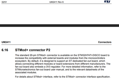

2025-05-28 1:34 AM
@Mike_ST The UM refers to these as "standard" connectors. It would be helpful if it gave links to the specifications.
2025-05-28 1:44 AM
2025-05-28 2:50 AM - edited 2025-05-28 2:51 AM
It would be good if that were included in the documentation of all ST boards which use these interfaces.
