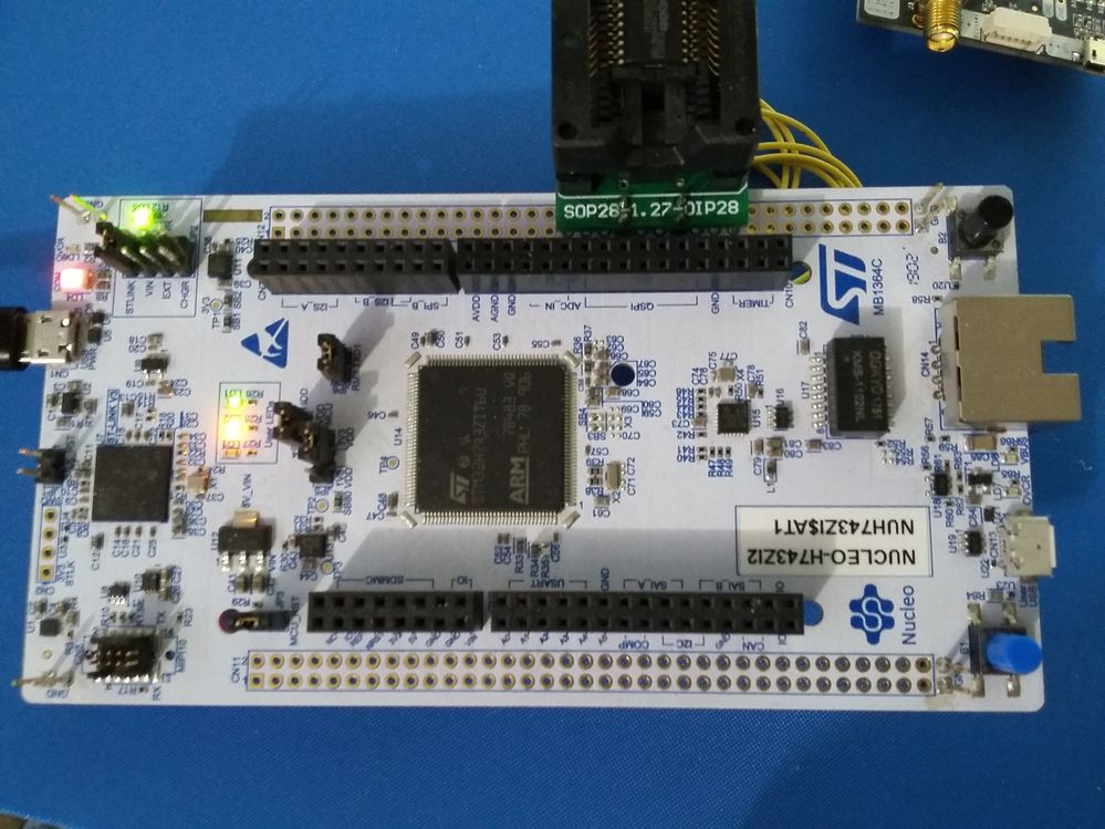

hello,
I have tested your image on three different H743ZI2 boards, but I never receive any message on the VCP.
the LEDs are blinking however.
all other STM boards I have give me output over the VCP.
this is crazy... I am thinking if all three boards are broken...... but this is highly unlikely

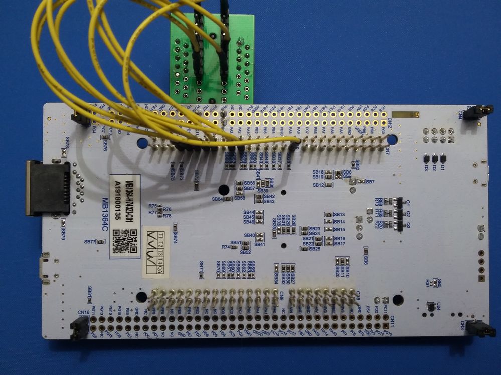

do you have a picture of your board of FRONT and BACK ?
I want to compare the solder bridges and so on if there is any physical difference.
kind regards
2019-12-21 2:40 PM
Will see what I can do.
SB5 and SB6 should be ON, SB4 and SB7 OFF
Jumpered for 3.3V operation JP5
Rev C board
Will see if I can get the angle, focus, lighting better
Alternate would be LPUART1 via SB8, SB9, SB18 and SB12, SB34, SB66, SB18
2019-12-21 2:45 PM
2019-12-21 2:52 PM
There is some flux near SB7, suggesting it might have been removed (not by me)
2019-12-21 3:13 PM
SB5 looks OFF, so using the level shifter.
Do you have a shield plugged in?
SB12 and SB19 should be ON signals at chip
SB3 SB4 OFF
SB18 SB66 OFF
SB8 SB68 ON
SB9 SB34 OFF
