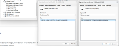

2023-09-24 10:50 AM - edited 2023-09-24 10:53 AM
Please check also the device manager, View devices by container. Find the STLINK-V3PWR. Is there any difference in its COM ports description?
In the properties of COM ports, please find Details tab. What are "Device Instance Path" of the COM ports?
2023-09-25 12:11 AM
The difference of the "Device Instance Path" is very minimal. The "Description" value is the same.
2023-09-25 9:37 AM
@lmessing The difference is small but precious. The composite function indexes are all we need to know. One is MI_01 and the other MI_04. This can be used to distinguish the COM ports.
Unfortunately this ST-LINK does not have a "serial number" (strange). This makes parsing the string harder (TL;DR Microsoft warned more than once against attempts to parse these strings - but they don't offer anything much better...)
